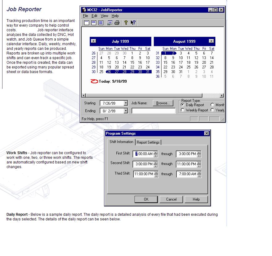

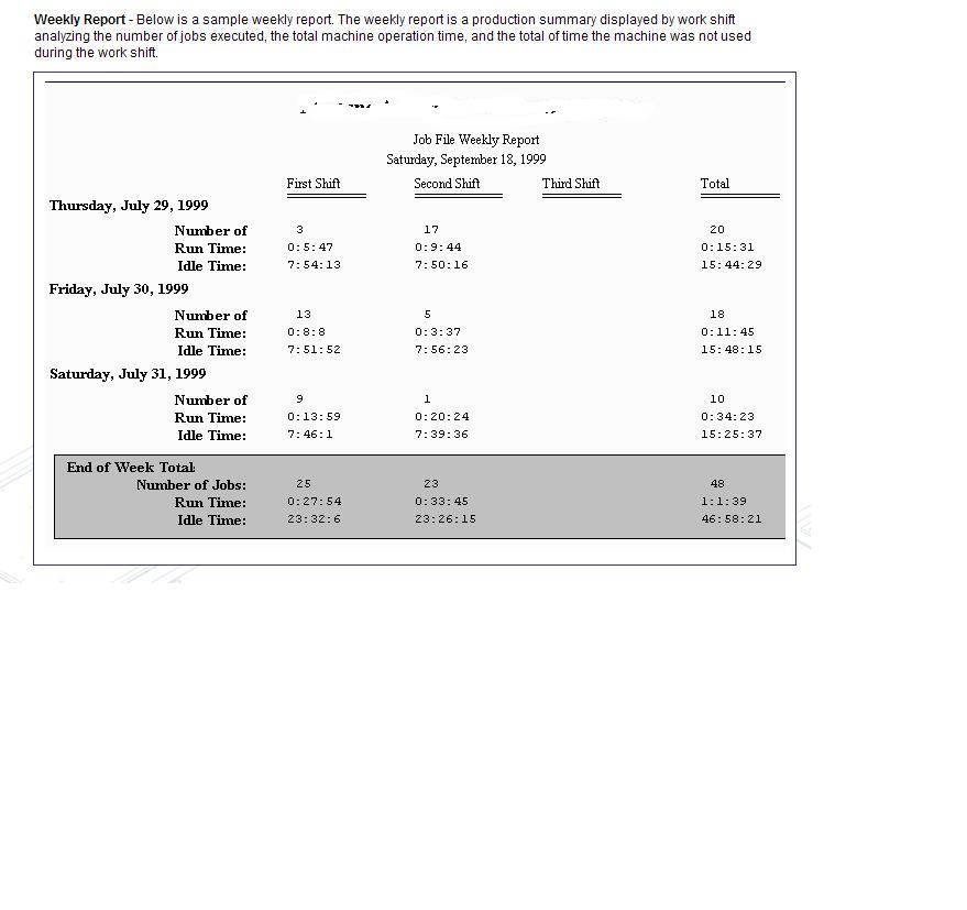

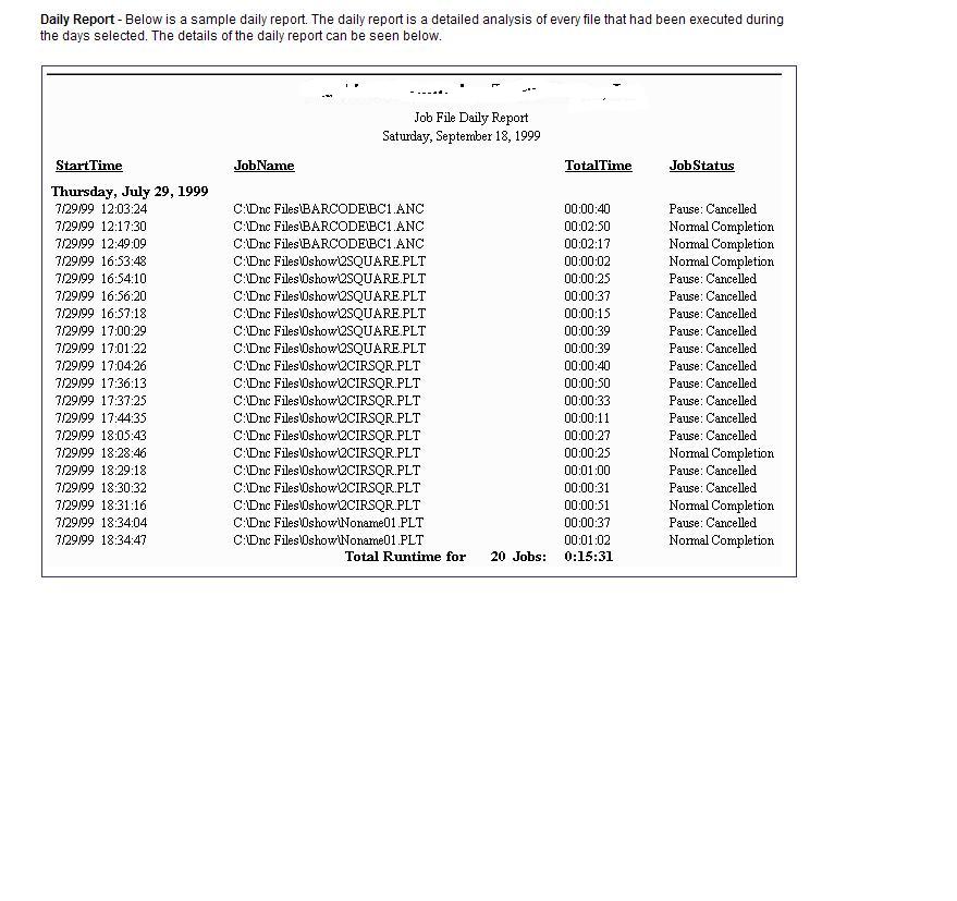

I asked Jason about having a report generator added to the CNC controller as an \"F\" key or a pull down menu function and he said it can be done and has been for a few special requests but I think it would benefit all of us. Whether we are a 1 man or woman shop or have 10 Thermwoods making wood chips 3 shifts a day we may all have different criteria. Here are some of the thoughts I had and I also found some examples as seen in the pictures.
This is what I sent Jason:
\"Hey Jason, I know you are probably in Las Vegas now but I just ran across this and wanted to see if there is any way that we could get a tally of what files have been ran, time to run, time in between or from green button to green button (Chip to Chip) , How many times a file was run that day, week, month,year, during the life of the machine... How many hours the spindle was actually running and any others that may be important. This would give VERY IMPORTANT FEEDBACK for owners or managers. so we can see the efficiency of the machine and operator or if one operator is milking it compared to another.
I know we have the time log screen but if it is not saved by the operator every time it only serves to show how long the machine ran for that one file. I know many others would benefit from this also. If \"#@*&^$#\" company can do it you guys can do it better. Let me know what you
think.\"
So what kind of info would be beneficial to you? Short term (daily or longer term (weekly, monthly, yearly...) This could be very helpful for us Ecabinet user's as well as job shops or manufacturers. Think about it and post what your thoughts are and how it would benefit us all. from what Jason and Ryan said I do not think it would be implemented immediately because they have some other things on the list but the more of us that voice our wants for additional functions like this and enough of us have similar criteria, I think it would help speed things up because it would give them a clear direction.
