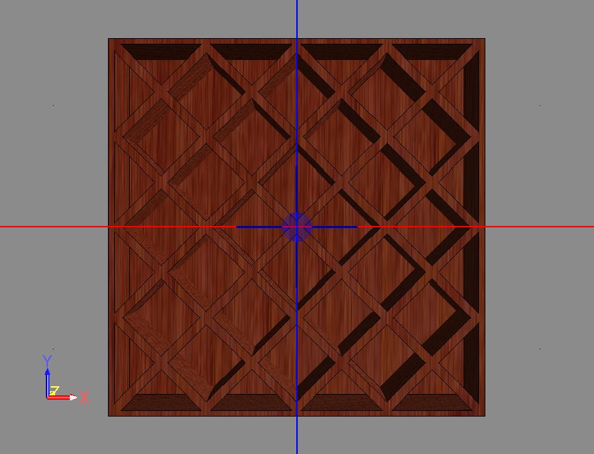

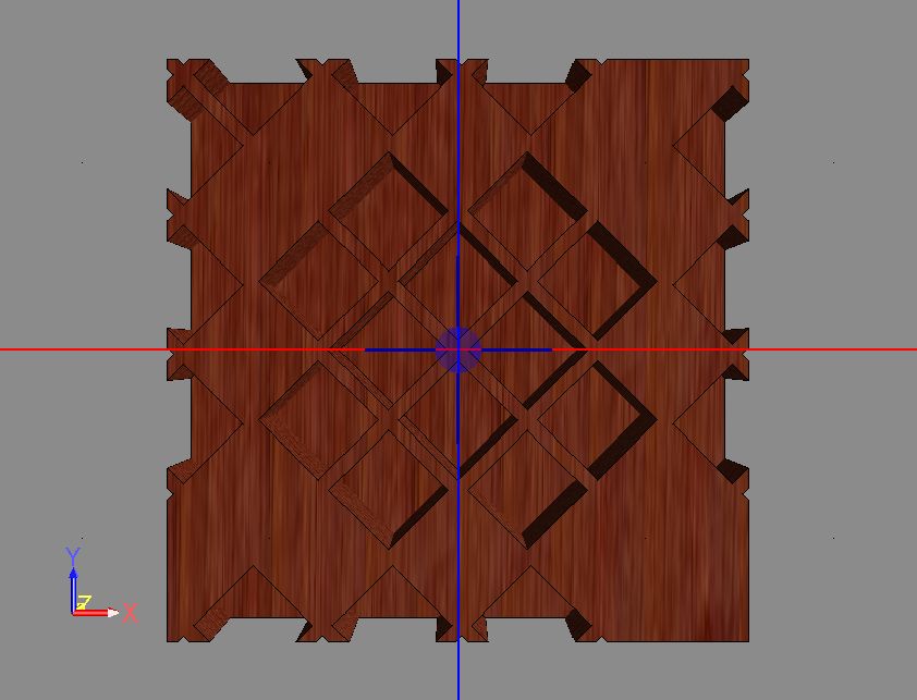

I was just wondering if it is possible to put shelves on a 45 in a cabinet
Hi Tim, you cannot rotate a shelf. So you will need to use display parts which can be rotated. If you need something resizable, and your good at the part editor you could use a back made from material the thickness of your cabinet depth, then do diagonal through cuts to make the bottle holes. HTH
I created one from a 12\" thick back in the PE. It re-sizes down ok, but when you go back to the original size things get ugly. Maybe someone else has some input.
wine rack test3.jpg (55.74 KiB) Viewed 3349 times
wine rack test2.jpg (67.06 KiB) Viewed 3350 times
