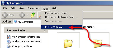

Okay, here is how to change the settings so that the cutlist will start Excel:
Double-click My Computer
Select Tools/Folder Options

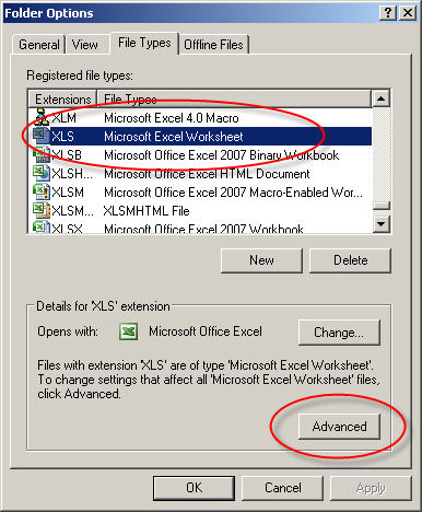

Select File Types
Scroll down and select .XLS
Select the Advanced button

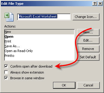

You should have a dialog box for Edit File Type and there should be a check box for Confirm open after download. If this box is checked you will get the prompt.

Here are screen shots of what you should see.
