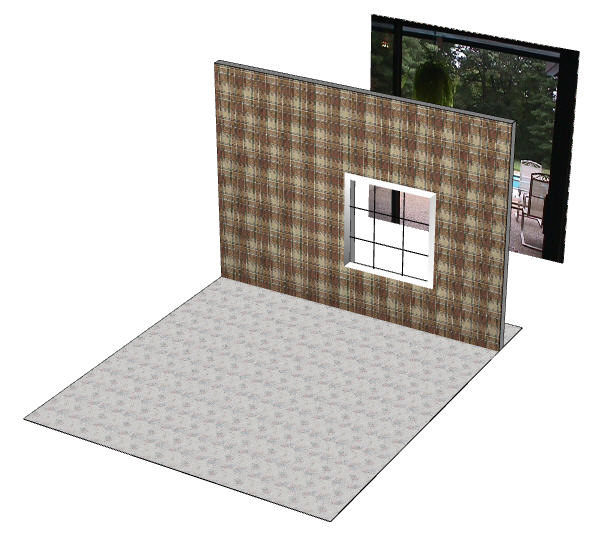

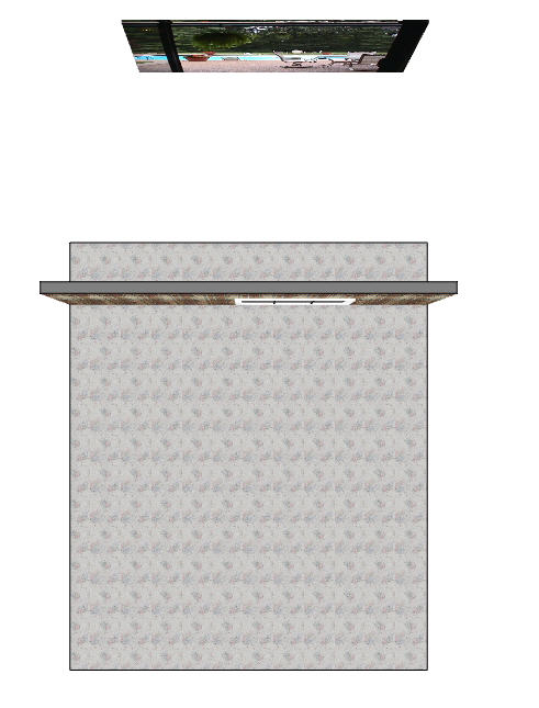

How are you placing the image? There are two methods of doing this.
The first, and easiest, is to add your image to the imported images folder and check the \"Apply Image\" checkbox when defining the window.
In the second method you add the image to a display cube that is placed some distance outside the wall. The window is created by cutting a hole in the wall before adding the window. In this method, the checkbox to apply the image is left unchecked.
Window Image 2.jpg (37.03 KiB) Viewed 7499 times
Window Image 1.jpg (52.28 KiB) Viewed 7499 times
