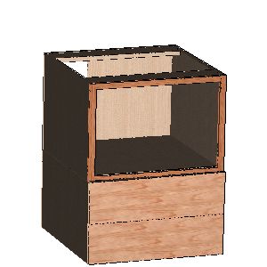

Take a look. It's an interesting assembly with a faceframe top half, and a frameless bottom with two drawers.
Meant to be flanked by frameless basecabs, the Sharp unit recesses in at carcase depth, and has 1/8 margins on the sides, when installed.
We've already done this, and it turned out really well. The previous jobs were not eCab designs, but the numbers here are all the same.
