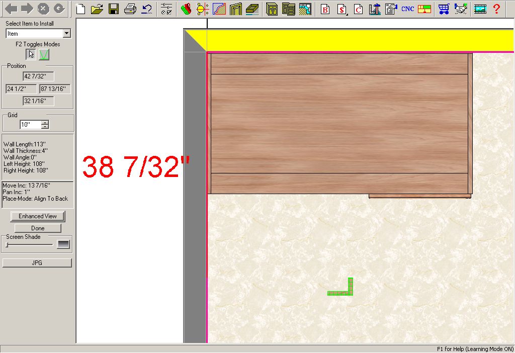

Michael Yeargain
Location: South East
Post by Michael Yeargain »
The image above shows my filler at 38 7/32\" away from the wall behind the blind corner.
If I select \"free style\" method then \"move object\" I will enter the calculations like this... (38 7/32)-(24). This will se the move incrament exactly the right amount to shift the filler against the blind corner.
