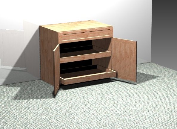

I made this to show a customer what a roll out base would look like. After finally having time to read the Ecabs manual I figured out how to play around with the presentation.
I know it's pretty basic, but I'm happy with it...

I'm thinking of putting together a catalog of cabinets shown like the roll out base. It's good practice if nothing else.

How did you do your r/o's , will they adjust with cab size?...Mike

Each rollout is a cabinet without doors turned on its back. Resize these cabs to fit in the base cab and you can place them inside the base cab while in the cab editor. It took some time to get the hang of it.

by Roger Erismann » Wed, Jan 18 2006, 2:52PM

I like the open door.... I'll have to try it one day!

Roger--you use display panels and place them at the desired angle to simulate open doors.

You can actually choose the exact door you want in in the cabinet assembly editor. Click on Load in the editor and choose Door/Drawer at the bottom of the list that pops up. Then place them manually as Dan suggests.
