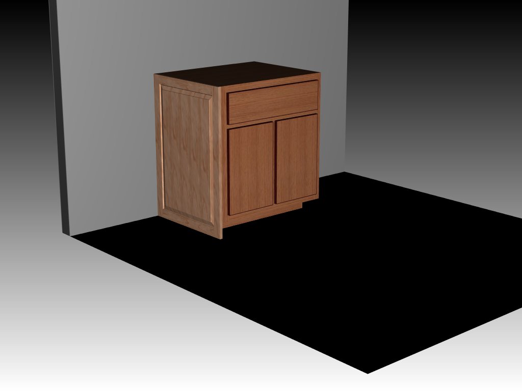

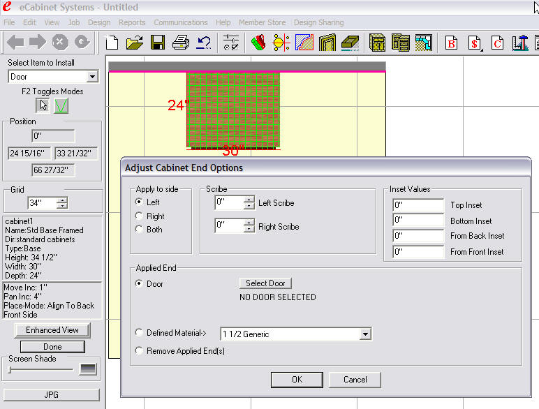

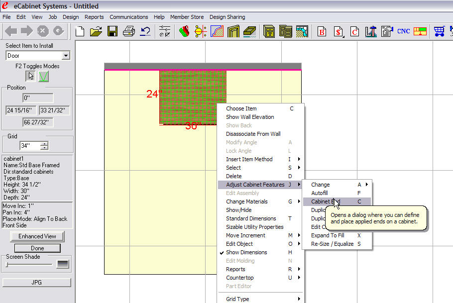

Hi Jim
This is one way
Take cabinets in to Create a room/custom layout
End Panel 3.jpg (41.92 KiB) Viewed 3395 times
End Panel 2.jpg (89.09 KiB) Viewed 3395 times
End Panel.jpg (109.81 KiB) Viewed 3395 times

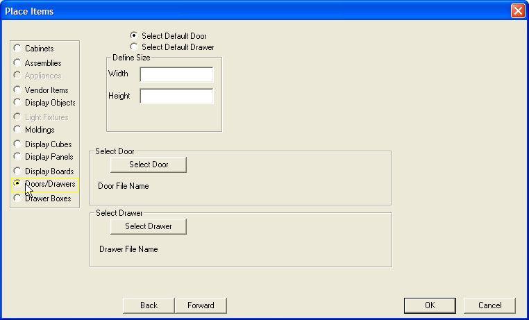

jim graham,
You need to take the assembly to the cabinet editor and place item. Select the radio button for Door Drawer. Here you will need to specify the style and size. And you will also have to manipulate the door into position as you have done with the assembly.
