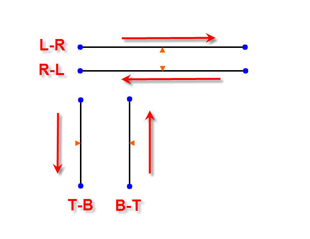

After you first click to anchor the wall, the build direction depends on which direction you move the mouse.
If you move the mouse from left to right, the inside of the wall will face the bottom of the screen. Moving the mouse right to left causes the inside of the wall to face the top of the screen.
Moving the mouse from top to bottom causes the inside to face toward the left of the screen while moving from bottom to top causes it to face right.
build Direction.jpg (22.54 KiB) Viewed 7837 times

I understand which direction to go on first wall. It is the adjoining walls that are the issue.
Mike,
In the very first versions of eCabinets you were required to build walls moving clockwise. That is no longer a requirement but I still so it and it simplifies things greatly.
On angled walls or any wall for that matter, pay attention to the little red arrow, that is your finished side of the wall. As you are drawing a wall if you notice it on the wrong side simply right click and choose \"Reverse Build Direction\" to change it.
