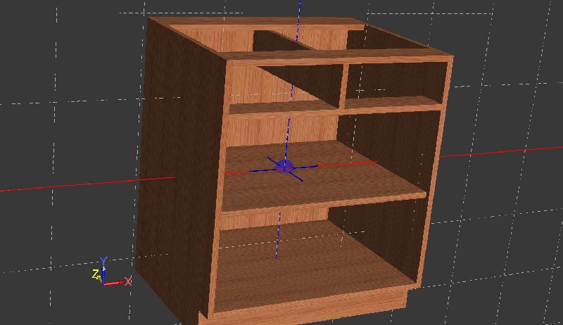

What is the proper way to add a drawer partition, if I use a stretcher the drawer editor doesn't recognize the 2 separate spaces and when I use a partition offset from the floor the shelf editor thinks the bottom area is separated into two spaces. I can't get a display board to work either..

To accomplish what you are trying to do, use a shelf for the horizontal stretcher under the drawer and a partition for the divider. Offset both from the back to get the width you want.

Thanks Dan, works like a charm..
