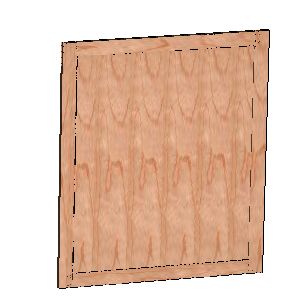

I did something similar creating a door.
Don't know how useful it would be, but I made the faceframes puzzlejoint, added a 1/4" thick inset door with negative reveals....performed a few part editor cuts and constrained them. The result is a puzzle-joint door that is re-sizable. The only drawback is you can see the puzzle-joint from the back of the door.
framed door test.hsf
(464.02 KiB) Downloaded 740 times
framed door test.jpg (13 KiB) Viewed 9837 times
Re:
Jody Wilmes wrote:...The only drawback is you can see the puzzle-joint from the back of the door.
The only person that will be inspecting the back of the door is the mother-in-law. :shock:

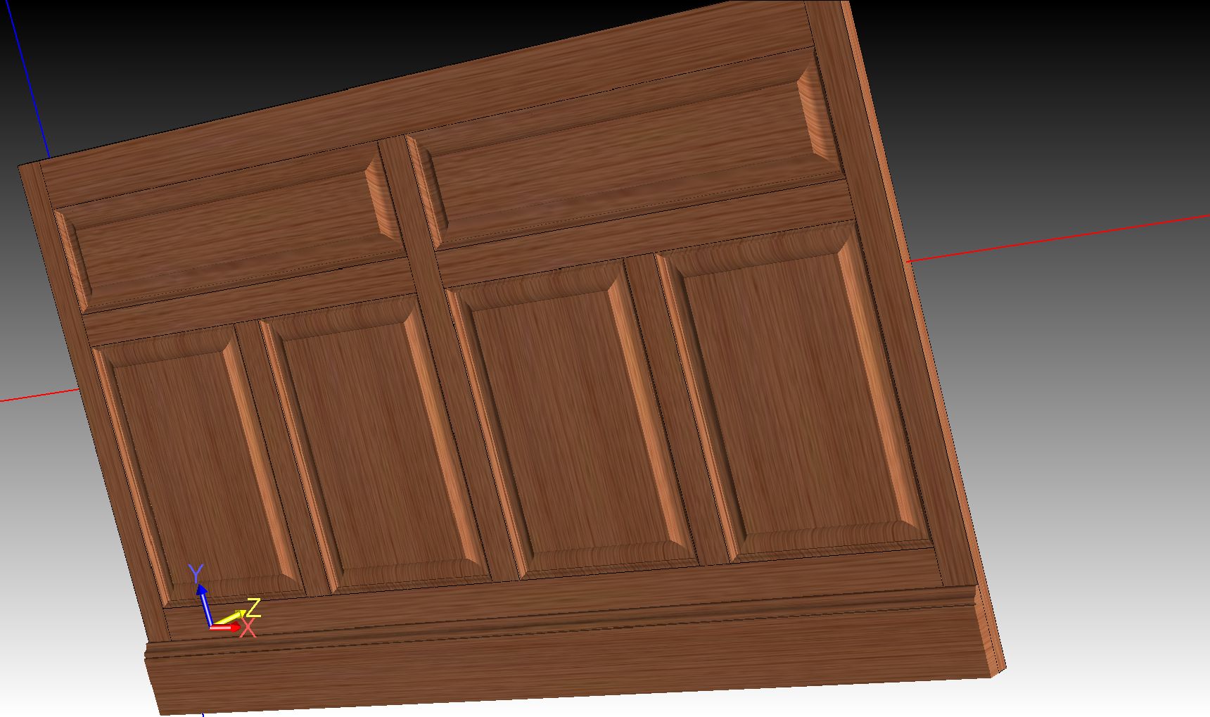

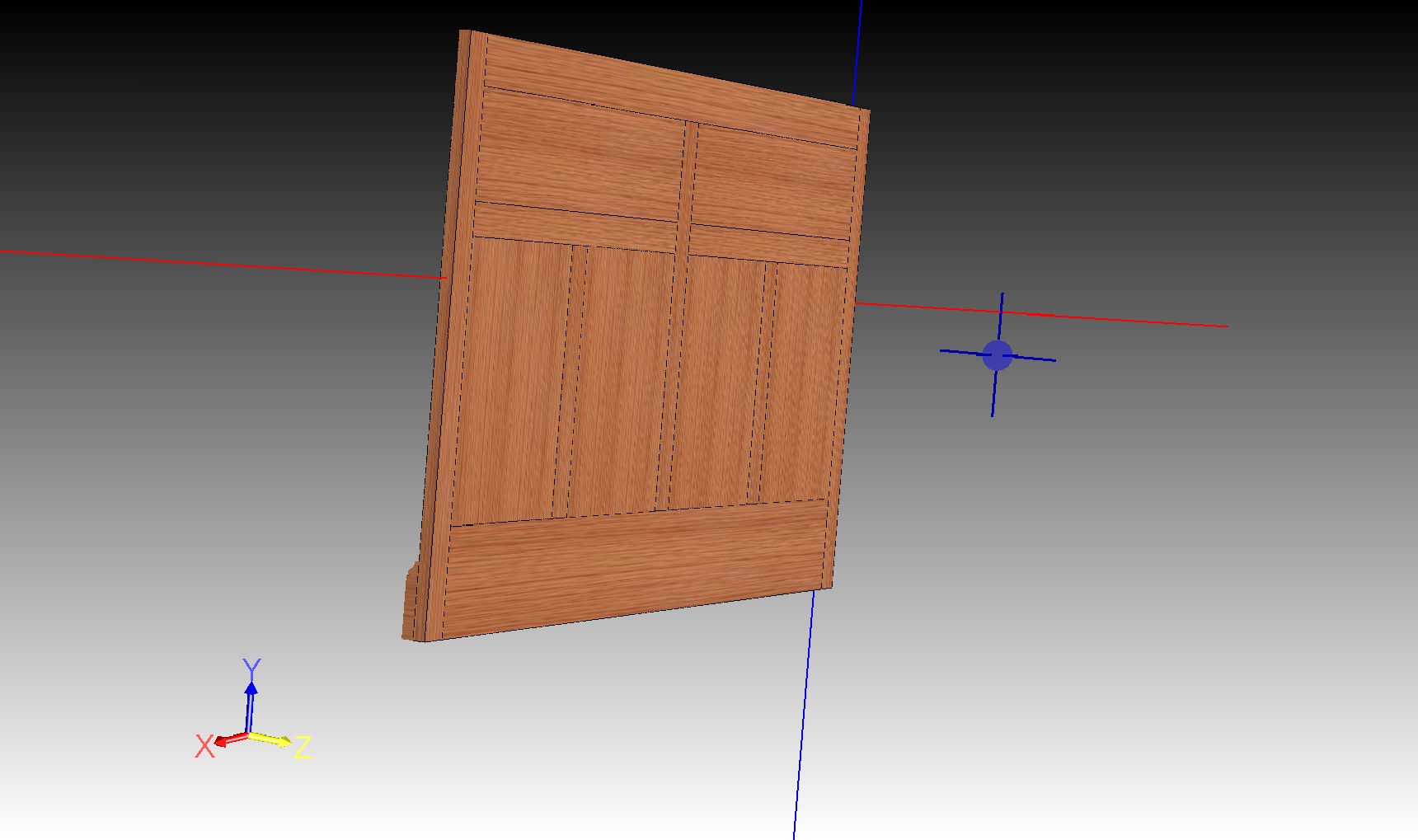

Here is the way I was talking about earlier.
Damon Nabors
Posts: 923
Location: Marion, Ar.
Post by Damon Nabors »
Hey Dan, Would your Mother-In-Law aprove :D
Damon,
That is the way these paneled wall were done.
I have even started building wainscot this way. I make my cabinets 1\" thick so I can inset the door enough to leave a quarter inch reveal on the front and then I apply a 3/8\" bead or other panel molding to dress it up a bit more. This makes for a spectacular panel. I can build the doors using a more narrow stile and rail or order doors over sized sot cut the stile and rail down so it doesn't really look like I inset a door.
