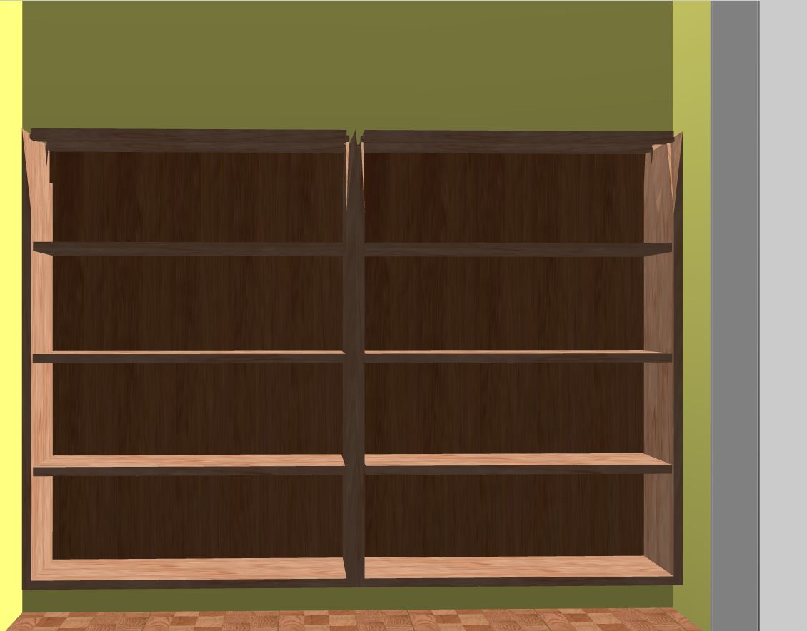

Has anyone had this problem before. It's like the tops of the sides of these cabinets are mitered. I've tried building a new room and reloading to no avail. Thanks
miter top.jpg (71.38 KiB) Viewed 2391 times

Ben,
Click on the \"Enhanced View\" button or turn up the level of detail settings in \"Preferences\".
