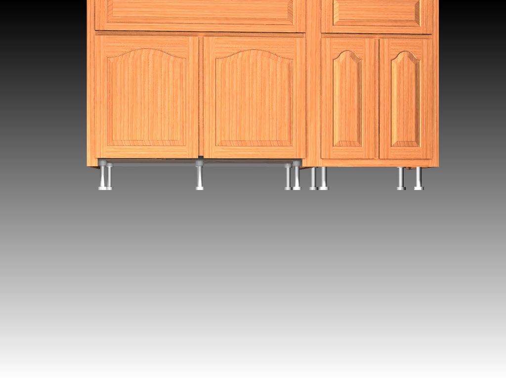

Gene I was looking at Hafele some of them are nice.
I was playing with the legs :?:

How did you get the legs to show on the cabinets? Are they are display item?
Ben Ratterree
Blue Ridge Cabinetworks
Spartanburg, SC
http://www.blueridgecabs.com
Hi Ben I made them up in another program and turn them into Hsf files.
If you go to customer 3D files I put them in there an made one up for each base cabinet
