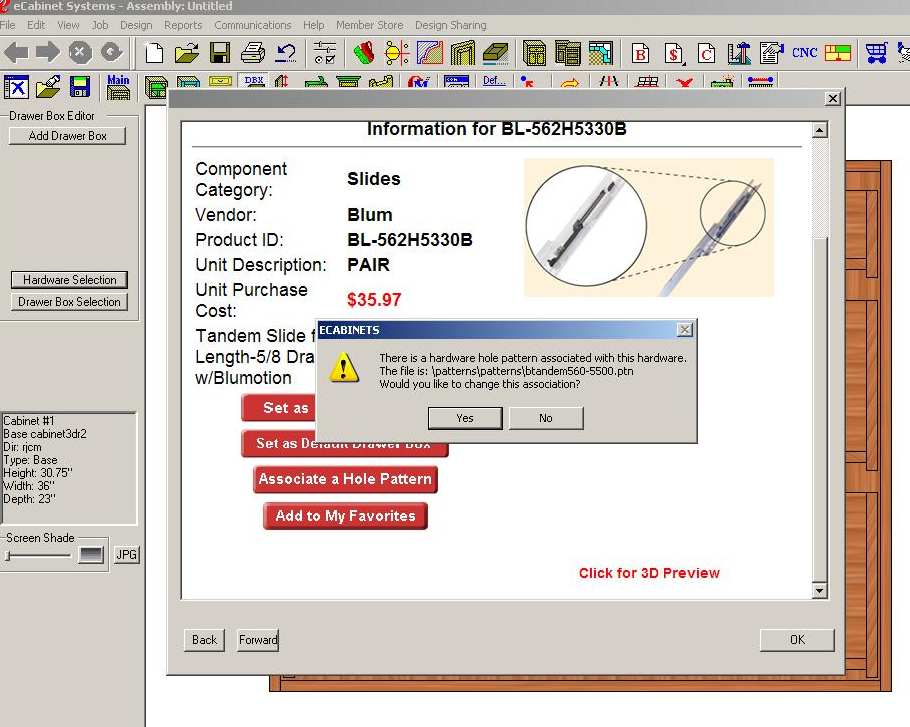

Is it safe to say that if you are going to associate hardware holes that they have to be done in the DOOR/DRAWER EDITOR and can not be added when adding a drawer box in the DRAWER BOX EDITOR.
If you can associate a hole pattern within the drawer box editor, would someone kindly explain how!
Damon

Damon Nabors wrote:Is it safe to say that if you are going to associate hardware holes that they have to be done in the DOOR/DRAWER EDITOR and can not be added when adding a drawer box in the DRAWER BOX EDITOR.
Damon
It can be done in either one. You just have to pick your hardware and assosiate a hole pattern to it.

Wally, I saw the message you posted, but the way I interpreted it was \"do you want to CHANGE the association pattern.\" I clicked no because I did not want to change the pattern, and nothing happened. I guess I should click yes?????????

If your adding drawers from the drawer box editor select your drawer box, select your hardware, associate the hardware, select no to new pattern (unless you have your own pattern select yes) then select the set as default drawer box button. Do not select set as default drawer unless your adding drawer boxes automatically with the drawer heads. Then go back to the drawer box editor and add your drawer box.

Terry, that worked out. I just have never played around with the hardware hole editor because w/o a router it just didn't make sense to spend the time playing with it, but now I can see the light :idea: .
