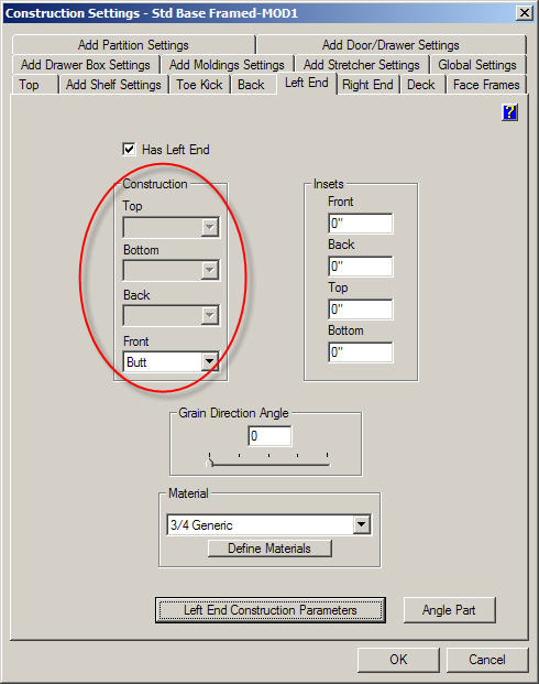

Hi everyone. I am new to this software and am learning just a bit although, maybe because i was going through some setting and may have done something wrong, I am unable to use Construction Settings for Left and Right Ends.
The only one available for changing is the Front.
Top, Bottom and Back are grayed out. Insets are available and currently at 0\".
Any ideas on how to correct this would be greatly appreciated.

I am in the main screen. I start ecab, select Develop cabinets or assemblies, standard cabinets, select any seed. When it opens, i go directly to the construction window by pressing 'C' on the keyboard. Select right or left end and those areas mentioned are grayed out. Parameters for left and right ends appear to be the defaults, Datto - 3/8\", Depth and Fit clearance are 1/100\".
The top, deck and back are all accessible.
Hope this helps a bit...
Les

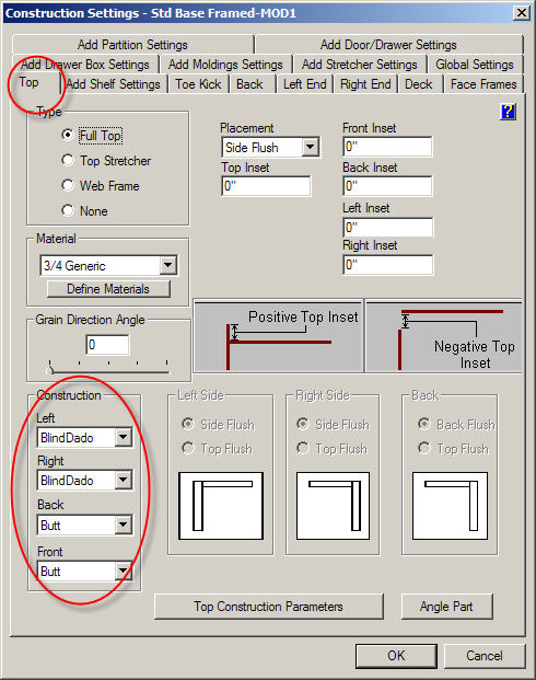

Okay, I think I know what you are talking about now (see attached picture).
The joinery settings for top, bottom and back are set on those parts. For example, to have the top blind dadoed to the ends, set the left and right joinery to blind dado on the top (see 2nd picture). Do the same for the deck and back.

Dan, I tried what you described and the result is no different for the left and right ends. The first pic is exactly what i have. I am late for work but when i get back i will post some pics for review.

to continue a little further from where Dan was heading...
The joinery options depend on how the part is constructed. ie does the top connect to the sides, or do the sides connect to the top. If you change the placement so that the Top is flush, it should open those boxes to select the joinery for the top on the left and right gables. Same thing for the deck. Right now, you should have all the joinery options available for the top, whiel the ones for the gables are greyed out. Once you change the placement option, hit ok, then go back into construction settings to change your joinery. Sometimes the construction settings manager won't update multiple changes that depend on one another all at once. You may change everything, but then discoer that only the first thing actually changed and the rest reverted to the default.
in other words:
- select the placement options you want
- hit ok
- re-enter the construction settings and select the joinery method you want
- hit ok

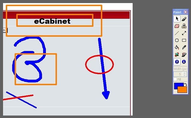

Michael Kowalchuk
Post by Michael Kowalchuk »
The new IrfanView (V4.10) has a nifty paint feature now, too.
http://www.irfanview.com/
MRK
IrfanView 4.10
IrfanView 4.10

Hi Leslie,
Think of it as Master (tenon) and Slave (dado). Because by default, the top will dado into the end panels making the top the master and the end panels the slave. If you changed the construction so that the top sits on top of the end panels then the end panels are the master and the top is the slave. Those construction fields will then open up for the end panels. Insets are used to changed the part size. Hope this helps.
