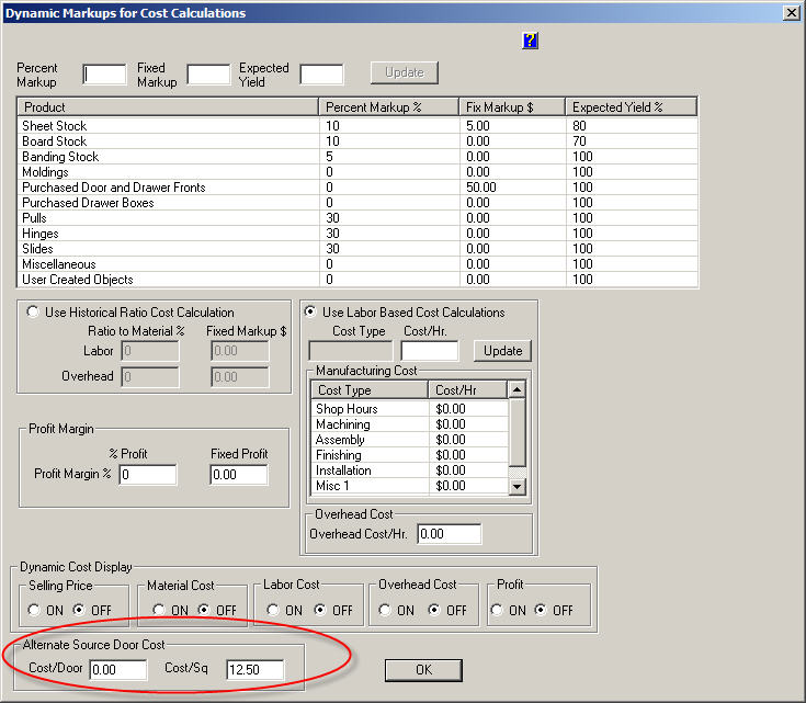

Re:
Mike Brannon wrote:...Is there a way to incorporate design charges for 5 piece doors that resemble the pricing structure of e-cabinet vendors who make them? It would a big step forward if the program could accurately reflect the impact on the bottom line of the proposal of substituting purchased doors for doors made in house...
Yep. In Settings and Preferences -> Define Costs, look at the bottom left of the panel. Here you can enter a cost per door plus a cost per square foot for alternate source doors. These costs apply only to alternate source doors and not those purchased through the software or constructed in-house.
door cost.jpg (91 KiB) Viewed 9879 times
