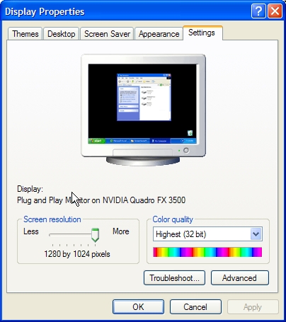

Am still trying to get it figured out. On my laptop in settings I could do that but on this desktop this is what I get. Maybe I'll try to find an update on the microsoft website.

In the screen shot you posted, click on the advanced tab. Another box will come up, then click on the Quadro 3500 tab. Yet another box will come up with a dropdown box that will probably be set on clone. Click the drop arrow and select dualview and this should fix it for you.

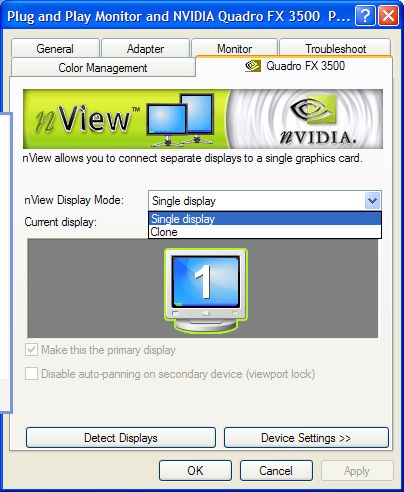

These are the only options I get on this screen. Single display or clone. Maybe the driver doesn't support dual display?...

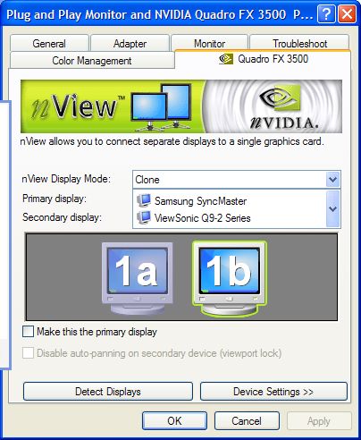

And here's what I get when I try to clone.
