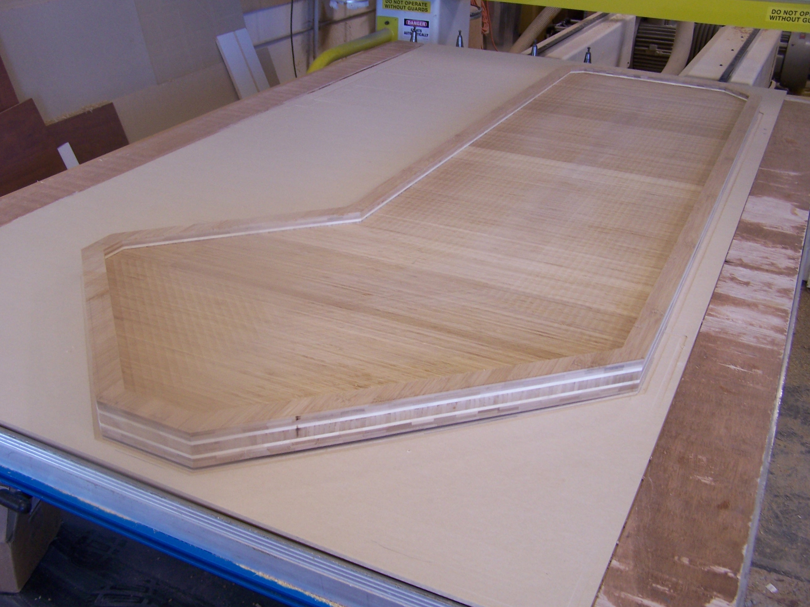

I have a 2\" thick Bamboo Countertop comming from Totally Bamboo.com on Monday. I think I will take it slow with multiple passes. That stuff IS hard!(and heavy). I'll post pics when it's done. I need to cut it into a 45 degree \"L\" shape for a raised Island Bartop. Also, I need to flip it and 'Hog Out\" 3/4\" to allow for 5/8\" roughtop for attaching it.

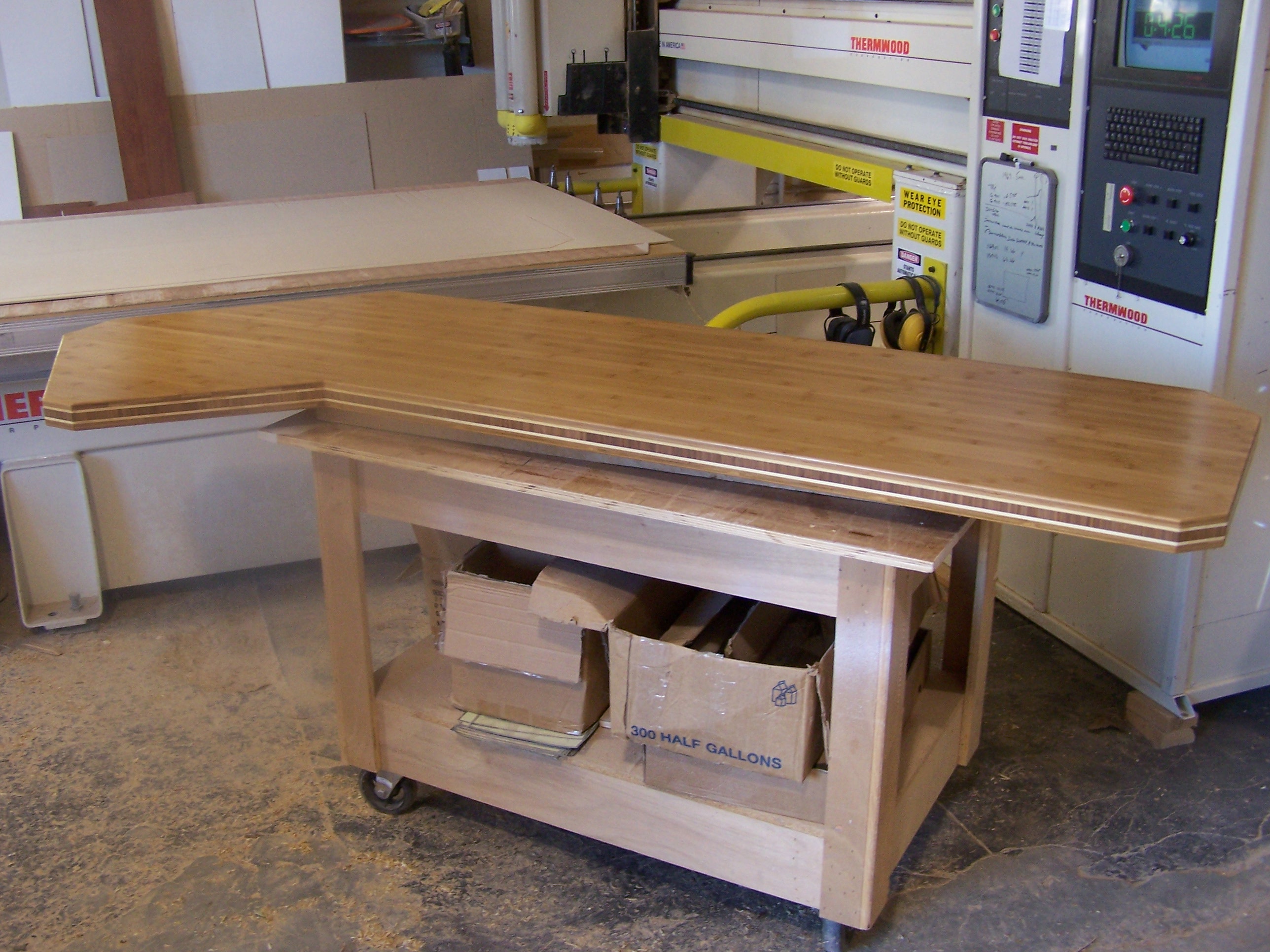

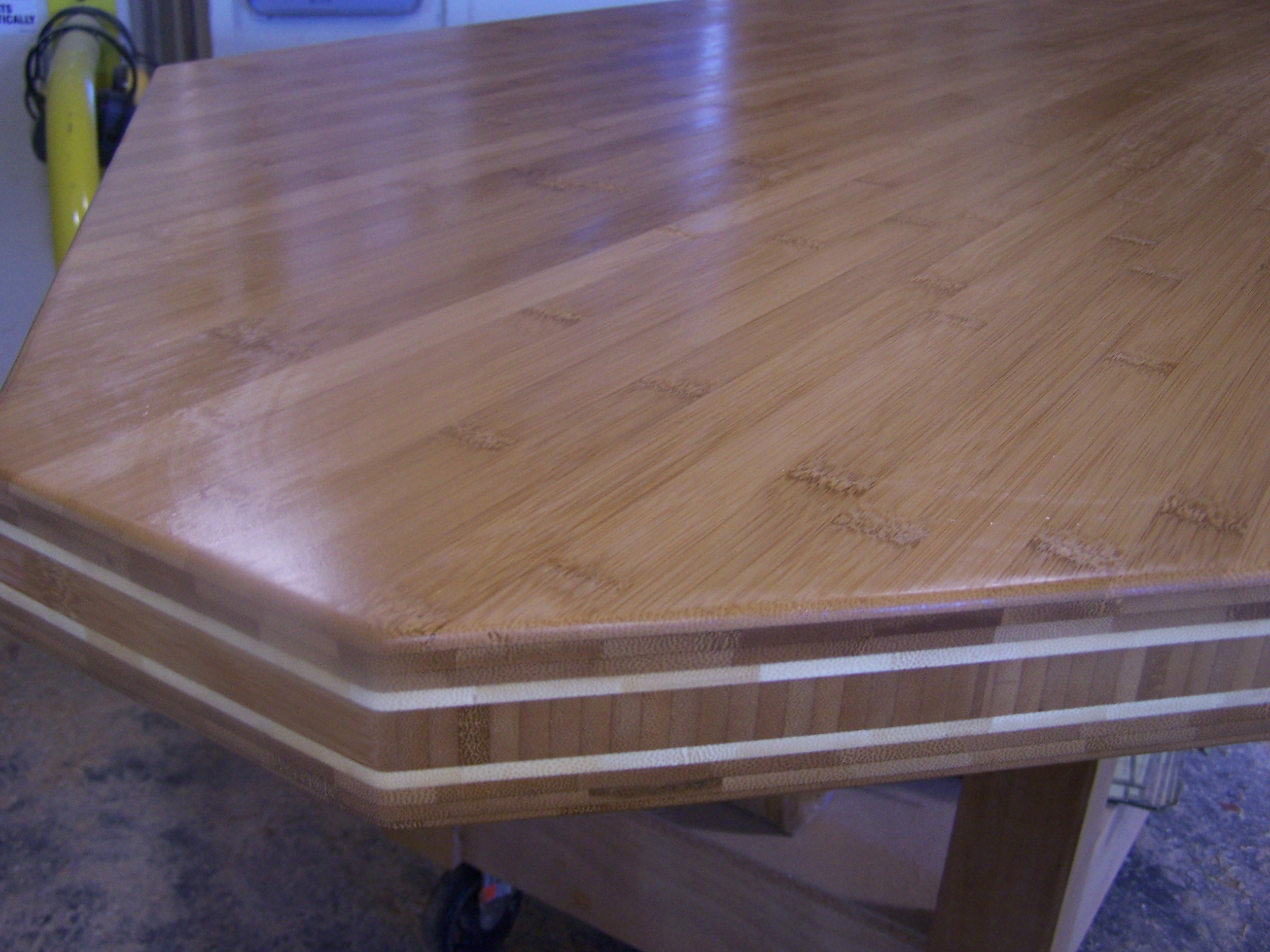

'Got it cut! Hard! Have to watch chip-out on the end grain at the 45's.

I figured it was less labor to Hog-out the material than to glue-up the edges. I also had to glue and bisquit to get 36" width. It turned out great. I'll post finished pics when I get them. I talked to Tom at TotallyBamboo for quite a while. Nice guy and a great product. It is pricey but very cool stuff.
