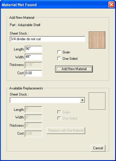

Re: Material jump
Post by Rick Deskins »
The shelf that you are talking about does have the materail "3/4 divider do not cut" set on it from the get go. It is not jumping, however the jpg for that materail maybe. When I first open the job, the "3/4 divider do not cut" missing materail dialog came in as the same texture as the other materials. You can delete and readd the shelf to get the right materail on it, but you could also go to the shelf editor, highlight the shelf, then click on Construction Setting and hit ok to apply the right material to the shelf as well. I did notice that when I reset my materails database that the "3/4 divider do not cut" materail imported with a different jpg all together. (see jpgs in zip file)
shelfmaterialproblem.zip
