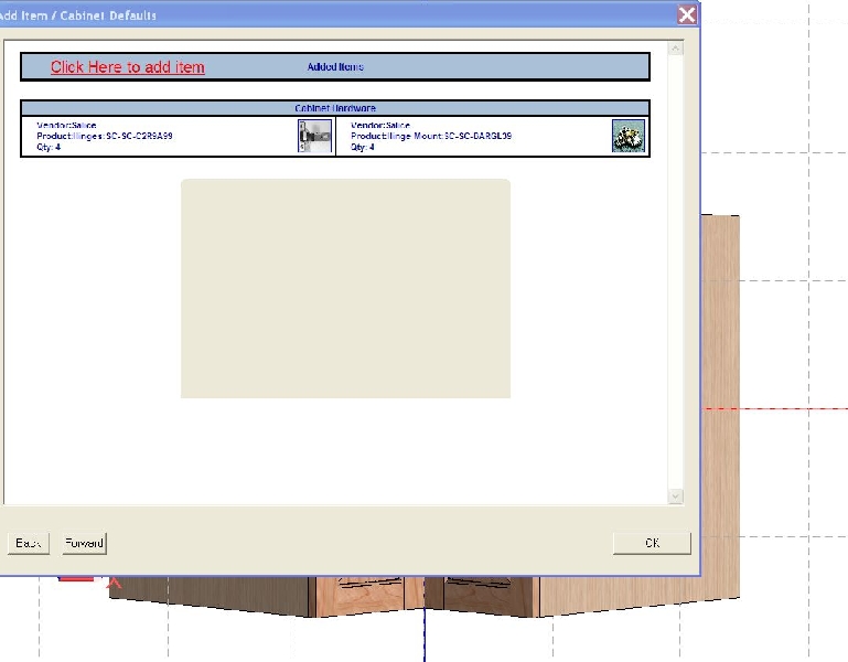

Here is what my dialog page looks like when I take the "Add Cabinet Items" branch. I did a check on my software issue, and got back, "you have the latest, no updates needed" message.
As you can see, I don't have any option for removing or editing something already added. What to do? What to do?

Your items that you are showing are Default Items not Added Items.
Go to Add Items/Cabinet Defaults and choose the Cabinet Default items. There you can Edit the default hinge and mount to reflect the new hinge you want.

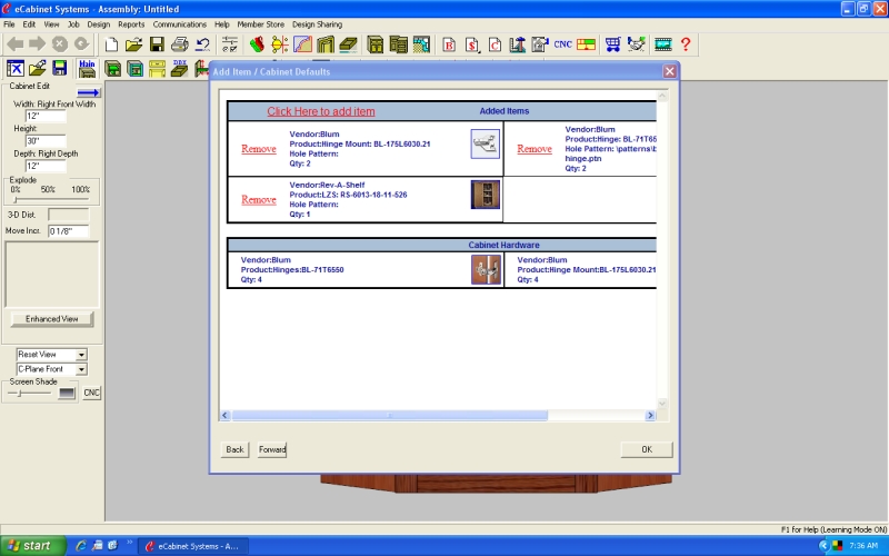

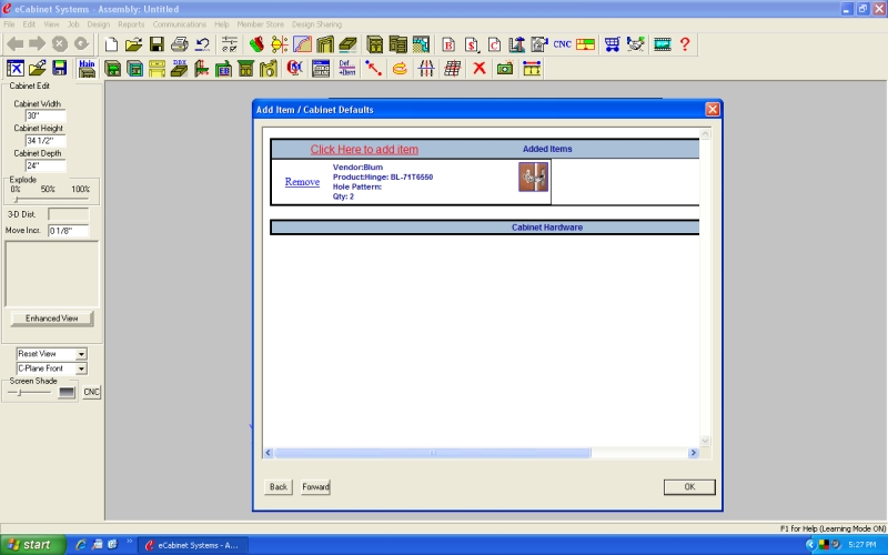

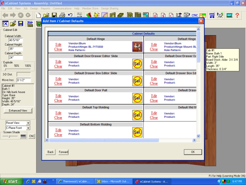

Pay close attention.
The hinge and mount you are showing in your picture are Cabinet Defaults. If they are correct leave them. If they are incorrect click on Edit in Cabinet Defaults and change them to the correct hinge and mount for your FIRST HINGE and MOUNT.
Exit Cabinet Defaults and in Define Defaults/Add Items (the icon next to construction Settings click on Go to Cabinet Items. This will show your Default Hinge and Plate.
Click on the red Click Here to Add Item link at the top of the Page
Now find your second hinge and add the amount you want associated to this cabinet
Repeat process for the mounting plates
Repeat the process for anything else you want to associate with this cabinet.
Save the cabinet when you are done
In your screenshot above you have not added any itmes to the cabinet other than defaults.
There are two tables on that screen One is titled Added Items and one is titled Cabinet Hardware.
Cabinet Hardware is your default items Added hardware is the added Items.
When you add an Item it will display in the top table and the word Remove will be nest to that Item.
