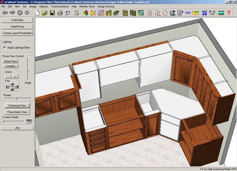

Not sure what happened here...
I was working in ecabinets and noticed that for some reason the program had started placing the cabinets on the wall backwards. At first I thought they were just missing doors, but they are there, as well as the shelves and shelf holes (but not visible because of the back). I only realized that the cabinets are backwards when I noticed the crown moulding tight against the wall.
Just thought I'd post a note so perhaps someone can figure out what is going on here, and what is causing it.
Attached is a screenshot as well as the file for this kitchen design in progress.

Re: Placing wall cabinets on wall backwards....
Mark
The eCab guys probably need to look at this. The same thing happens when I try to place cabinet to that wall. The other walls work properly.

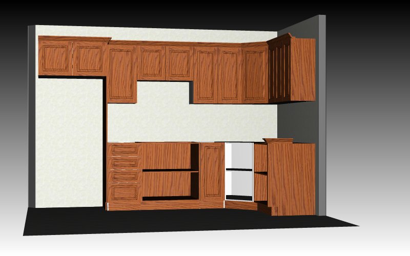

Post by Damon Nabors »
Take the wall and reverse the build direction and then switch it back and everything works ok.
Damon,
I had tried that and just tried again to double check and it still doesn't work for me. I can pull the cabinet outline through the back of the wall and it will position correctly but if I move the cursor it flips again.
If I go to Detail room and (without playing with the build direction of the wall) remove all his cabinets and then try to place a cabinet then cabinets place properly
Damon Nabors
Posts: 923
Location: Marion, Ar.
Kerry, I saved the 3 upper cabinets, deleted them, then switched build direction on that wall and the left wall, switched the walls back and then replaced the cabinets. They also placed correctly in elevation view. :?:
OK,
I wasn't removing all three reversed cabinet and when I try to place the center cabinet it is snapping to the back of the cabinet which reverses it.
Just remove all three backward cabinets and replace the using align to back. You don't even have to reverse the build direction of the wall.
My guess is that one of the cabinets got placed backward by accident and then the others are snapping to the back of that cabinet.
Damon Nabors
Posts: 923
I was just fixin (thats southern talk for you that don't know) to say that, I went back and tried it again without reverse and it still worked.

markvan
Posts: 64
Joined: Fri, Aug 31 2007, 10:13AM
Post by markvan »
