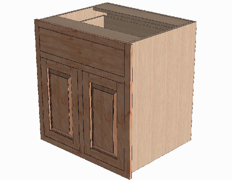

OK, Jerry, I roughed out a basic 1-drawer-over-two-drawers basecab. Sides are flush to the inside faces of the 1.5" FF stiles, so my slides will fix to the sides and the array of 5mm slide holes will be drilled in the nest.
Same for the doors and their Blum hinges and plates.
What are your settings for door and drawerfront margins? This model uses 1.5mm (about 1/16") all the way around. I am thinking I may boost it to 2mm.
Also, what is your preference for door close fixing? Self close hinges and blocks with bumpers? Or do you do free swing hinges and catches?
Furthermore, what cab configs need the doubled partitions? I can imagine a base with side-by-side drawers, but that gets one into funky joints, the need for a heavier back than the 1/4" captured deal we prefer, etc. What else is there?

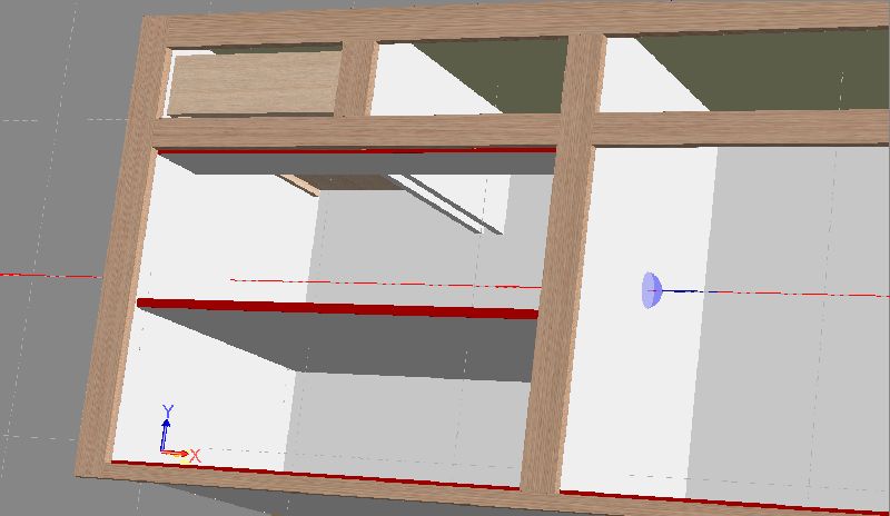

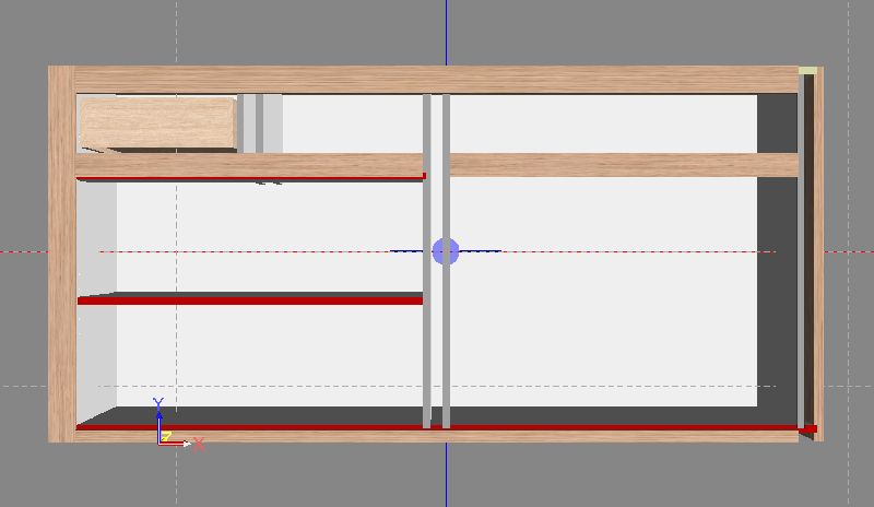

Gene, check out these images
cab sample 1.jpg (40 KiB) Viewed 5077 times
sample cab 2.jpg (34.62 KiB) Viewed 5076 times
Hopefully you can see where we use double partitions and how we handle double drawers. Your door margins are up to you. I typically use a 2mm margine if the cabinets are to be stained and at least a 3mm margine if they are being painted. The hinges and closers are up to the customer but I like to raise my bottom shelf up and drop the shallow mid shelf down for door stops instead of adding blocks. The drawers stop on their own within the hardware. We use a 1/4" thick back also and it works fine because of the full cabinet top.
