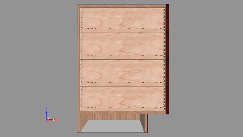

when you apply hardware to a cabinet such as hinges and rails, does this order them individually? or is it just to get the holes located in the correct position and also so the customer can see what it will look like.
Re: How do i use patterns?
Leigh,
The Default hardware that you assign any cabinet is added to the Buy List and Shopping Cart as you add Doors, Drawers etc. If you assign hole patterns to this hardware, the holes will show up on the boxes and can be machined by CNC if you are using one. You may want to create your own hardware hole patterns or edit the standard patterns Thermwood provides, to show only the holes you want. As you can see in the picture above, there are a lot of holes in that standard pattern.
You can also add Items to cabinets to get things such as Lazy Susans, Tip out Trays, Spice Racks etc. added to the Buy List when you place these cabinets in a room or batch. You can even add Shelf Pins.

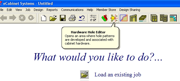

ok thankyou, how do you create your own hardware hole pattern and then use them?
Use the Hardware Hole Editor.
Find a Schematic drawing of your slide then use the dimensions from that to draw the hole positions in the editor. Save the pattern that you create for that slide.
You can also open an existing pattern in editor and delete some of the holes that you don't need then save that pattern.
You can find out more by opening the Hardware Hole Editor and clicking the Question mark to look at the Overview or by clicking on Help then eCabinets Made Easy and going to Using the Hardware Hole Editor.
