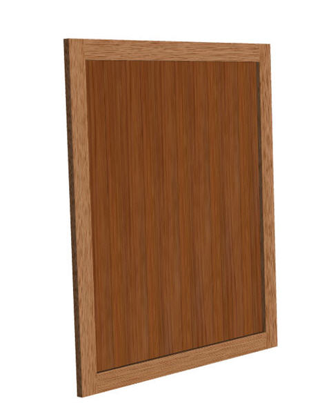

You can easily make you doors with different materials for the frame members and panel--just create a face frame cabinet and make the face frames from the rail/stile material. Make the back panel from the door panel material, change the cabinet depth to the face frame thickness and remove the top, ends, deck and toe kick.
You can profile the inner edges of the face frame members and the perimeter of the back panel to create a raised panel effect.

Thanks Dan,
That was the approach I finally took. It worked well. Presentation turned out real nice, once I master the lighting technique they should be even better.

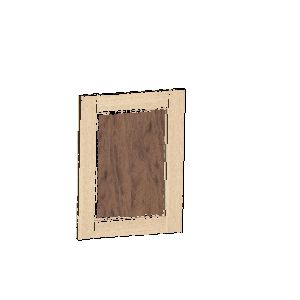

Here's an example of a resizeable door, made from cabinet components.
Reverse engineer the settings if you need to change rail & stile widths, and use your own materials as desired.
Resizeable Flat Panel Door.jpg (6.78 KiB) Viewed 7470 times
Resizeable Flat Panel Door.hsf
(586.02 KiB) Downloaded 525 times
You would still have to add this to an assembly and then manually align it, but all of it's components show up on the cutlist.
