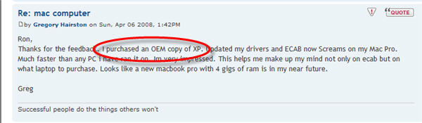

Post by Gregory Hairston »
Ron,
Thanks for the feedback. I purchased an OEM copy of XP. Updated my drivers and ECAB now Screams on my Mac Pro. Much faster than any PC i have ran it on. Im very impressed. This helps me make up my mind not only on ecab but on what laptop to purchase. Looks like a new macbook pro with 4 gigs of ram is in my near future.
Greg
