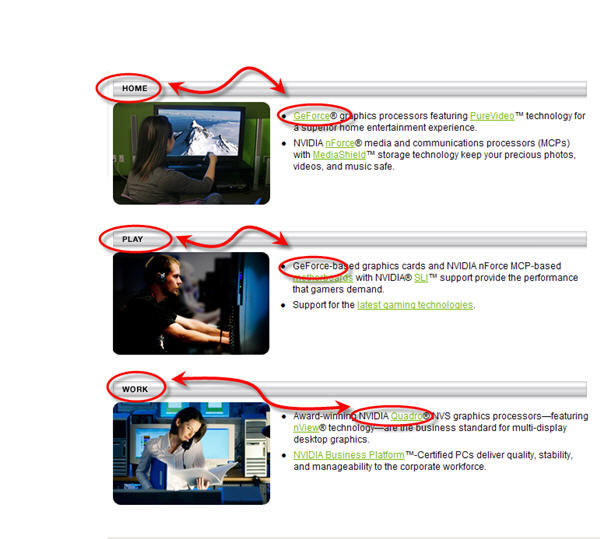

One thing that may be causing problems for you is the video card. The GeForce cards are designed for home/play use (see attached image from nVidia's website) and are not very efficient with OpenGL programs like eCabinets. Your card "says" it has 512MB of memory but half of that comes from system RAM. Since you only have 1GB of system RAM, that leaves you with only 768MB for the operating system and programs.
You really need a video card like the nVidia Quadro series which are designed with OpenGL in the forefront instead of added as an afterthought.

John,
From my experience the 7600 GS is more than enough for renderings in ecabs. I'm not sure if there are different versions of that card but mine has 512 dedicated and is either direct3D or openGL depending on the application. I currently run this on 3 PC's and am happy with the performance. I've seen some of the other highend cards and they don't seem worth the extra money unless your like Dan (independantly wealthy) :wink: .
