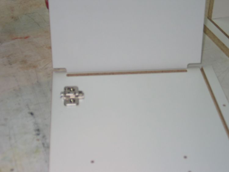

When I bring a cabinet into an assembly and resize it the tenons are coming out exactly the same size as the dado and the parts will not fit together, I have attached a photo.

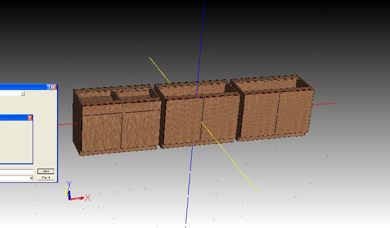

Most of our jobs are commercial so we don't need to draw any room layouts or presentation views, so what I have been doing is starting with a seed cabinet and making my changes. Then I will also load in what ever other cabinets I need and make changes to them, when I'm done I save the job as an assembly so that they are all on one page instead of making a new directory with many separate cabinets, as in the screen capture below.

Wow, thats alot of settings, the 4 wall cabinets in the esj. file I sent you all started out as a 30 x 30 x 12 wall cabinet. All that I did was change the heights, widths and added another door to the shorter one and made all the floors flush to the backs because they are not getting laminated it is a melamine kitchen for a camp. The only thing I can find that makes this happen is saving it as an assembly, I have since done another job and saved each cabinet individually and this does not happen.
