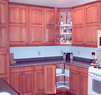

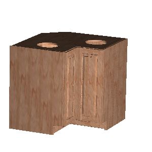

There are hinges on a corner suzan, If there talking about the revolving doors that go in to the cabinet, I doubt if you will find one in ten shops who use that detail. It is a callback and potential finger cruncher for the little ones. Se the attached lazy suzan cabinet. Please show this to the programmers.

corner base-lazy susan
