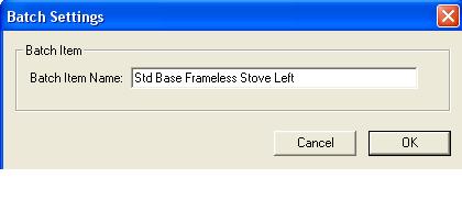

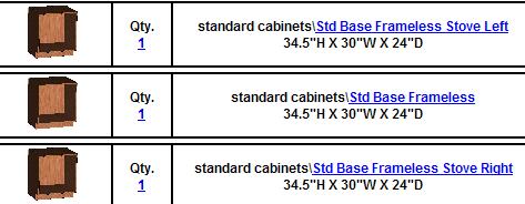

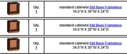

Justin Melhiser
Re: Renaming a cabinet
Post by Justin Melhiser »
Damon
The best thing to do is once you have your cabinets created, add them to a batch. Then the same seed cabinets that you use over and over in the same job add those and change the dimensions. Then you can click on the name that is in blue text and change the name to what you want. An example would be if you had two std base frameless cabinets one would be std base frameless right of stove and the other would be std base frameless left of stove. Now you can save this batch file and create your CNC file here. I know this may not be exactly what you are looking for but it will have the cabinets with different names labeled.
