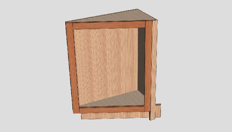

Brian, is this what you are looking for? If so, you have to delete the right front and change the right back dimension to narrow it to the 12" you are looking for.

Damon , Close but the angle needs to run from the back to the front the opposite of what you sent.

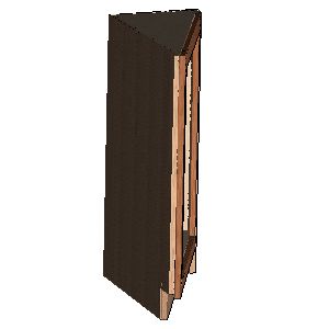

Brian, one other thing, make sure you check mark to miter it also.
The toe kick for some reason doesn't work properly, it will be too long, but for display purposes it will be ok.

Pull up your cabinet, then go to construction settings and on the lower right corner you will see the angle part box. Click there and you will see a drop down menu.
Top- check right front follows side
check right front miter
Deck check right front follows side
toe kick check right front follows side
Now you need to go to the Right side gable and put a 23.25" front inset. (the angle parts will not work untill you inset the right side )
Now go to the Top and place a .75" Right inset
and do the same for the deck.
you will have the cabinet you want now.

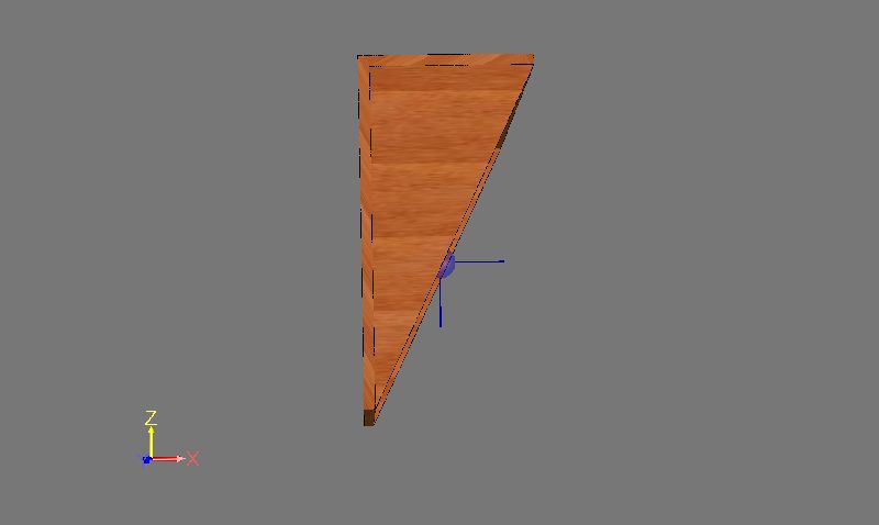

Ok , Here it is but it sure don't look the same.
Maybe someone with a little distance can see what these tired eyes can't see.

OK what the heck gives here,
If I turn off full dado it works fine,So I can't have a dadoed part to get an angled cabinet?
Is this subliminal evolution happening to get us all to switch to frameless cabinetry? :roll:
One more silly question how does the face frame get moved to the new front to this angled little devil?
totally confused now,But wait I'm the owner, Brian :shock:

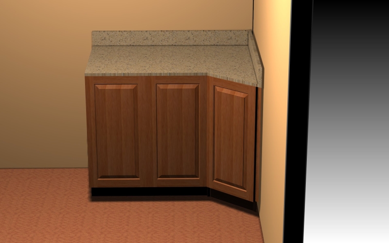

What I did to create it:
I used your cabinet that you had to make these changes.
The first thing I did to get the full dado on the left side, I had to change it to a blind dado, then go into the construction parameters, changed it to 100% thickness, and then put the placements on the left front and left back to 0". This then gave me the angled front while also being fully dadoed into the left side. I don't have a reason why it won't do this as a full dado, but it works as a blind dado. I'm also not sure why the right inset on the top an deck was needed, :? so I removed those to simplify things (and to make it less confusing). It also helped the toe kick to follow the front on the deck better.
To get the face frame on required a little more work; I had to use two cabinets. For the angled one, I removed the face frame and then measured across the angle to determine how long the second cabinet should be (One thing I failed to do with this angled cabinet is to take 3/4" off of the depth to allow the face frame of the cabinet next to it to overhang this cabinet. It's something that can easily be done). I then brought in a second cabinet (STD Base Framless), changed to the width to the previously measured distance, PLUS added to the width to allow enough room for mitering of the face frame (i added 3/8, which was a guess). Then I went into the construction settings, added the face frame, then went through the process of removing the top, removing the left and right ends, removing the back, removing the toe kick (which when you do remove it, make sure the height is set to 4" matching the other cabinet), and removing the deck. When you click OK, this will leave you with just the face frame. Once at this stage, I had to change the height of the cabinet (the one with just the face frame) to 33" (since there is no deck with no bottom inset, It made it 1.5" longer than what it needed to be) and then rotated it to the angle that matched my angled cabinet. (To find the angle, it is s guessing game. For this cabinet example, I rotated it 64.75 degrees). Once rotated, I uses my alignment too and VOILA!!! We have a angeled cabinet with a face frame!! 8)
Now since this is two cabinets that make one, you have to save them as an assembly. I've also Included the assembly so you can look at it as well. If you have any questions about what I described, just send me an email or give me a call, my extension is 337. Hope this helps!
Good luck!
