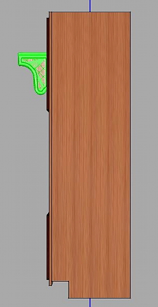

Could somebody tell me how to get a corbel on a cabinet ?
I have tried just about everything i can think of.
1) I loaded the part in the part editor and could not get the corbel oreintated in the right position
2) I then loaded the objects in the custom layout mode tried to rotate and position the corbel on the cabinet that way didn't work.
I must be missing something and I can't figure it out, sure could use some advise.
Thanks Gary

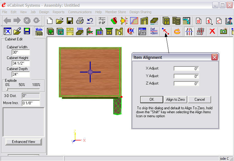

Do it in the cabinet editor and use the SHIFT and arrow keys to position after highlighting. Save as an Assembly.
Re: Corbel on cabinet

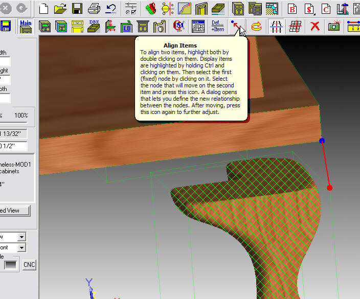

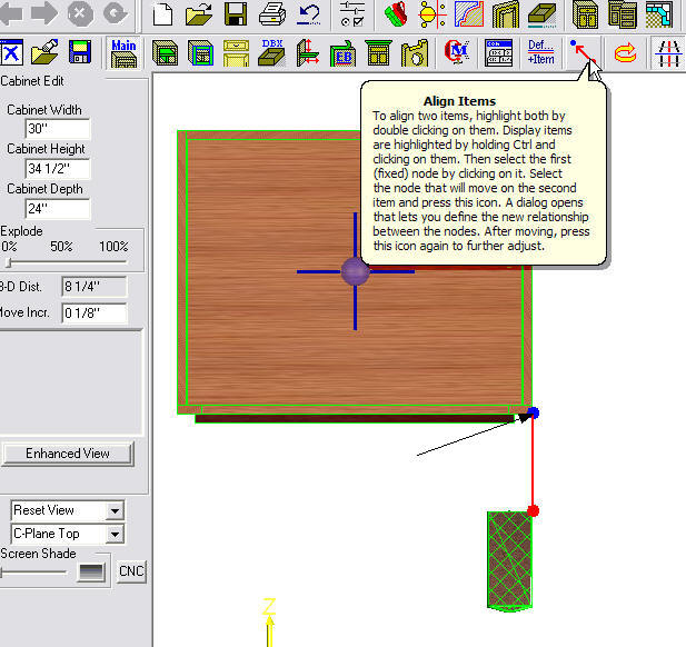

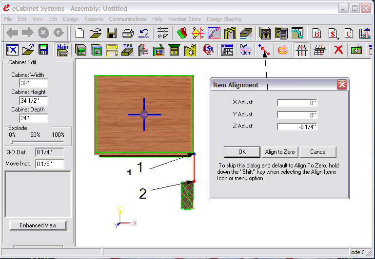

Hi Gary Try this

HI Wally and George
Thanks for the information, tried Wallys way first and it works great,

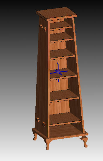

George Thanks, alot, tried moving some feet to the bottom of a cabinet using your method and got a little confused.
Thanks Gary

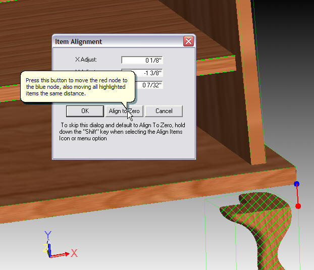

Here is some more
