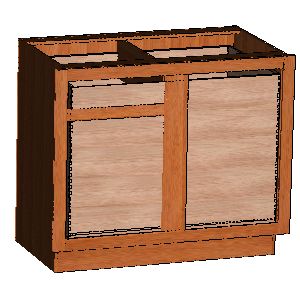

Check out this cabinet. I am not sure what type of drawer slide I need. I will also need to make some part editor cuts to the drawer in order to allow the mid rail and mid style to clear the drawer. :wall: :wall: :wall:

Looks to be a problem with the mid style.
If you delete the drawer, mid style and rail, then added them back everything seems to work properly.

Thanks Rick, I'll try that. We used the exact same cabinet last week on the same floor plan and everything worked ok, The only difference today is the door style was getting changed. :?
