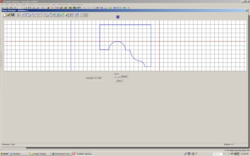

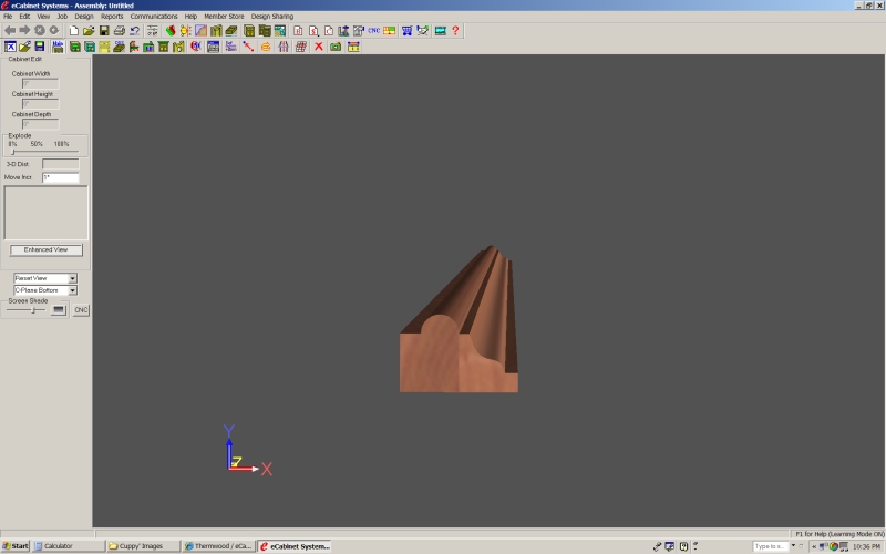

Gary,
you can go into the shape editor and create a molding profile tool and then use it to create your own molding. Here is an example of a tool and then a molding created with the tool.
Mold 2.jpg (111.69 KiB) Viewed 2555 times
Mold 1.jpg (65.69 KiB) Viewed 2555 times
