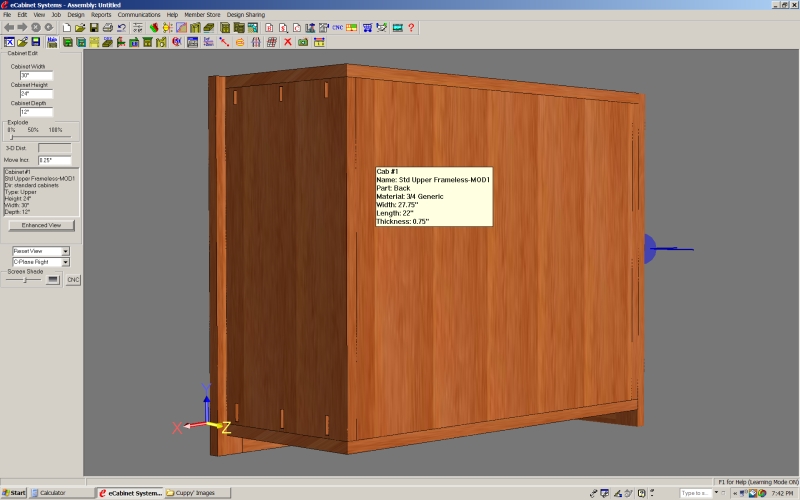

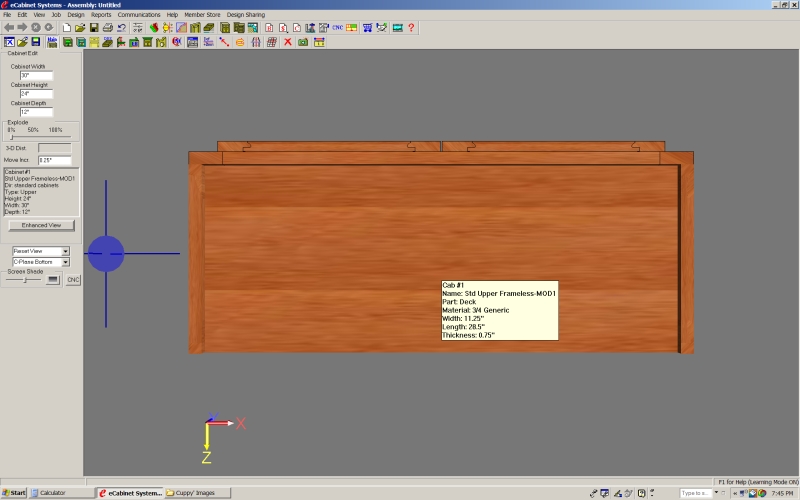

Depending on the price range of the job, I will clean up the undersides so to speak. I like to make my decks extend beyond the sides to cover up the end grain of the side. By doing this you can place your pocket screws to hold the deck, top, and front style. The finished end panel will cover the screws. I normally do not place any pocket screws in my decks or tops. I use 23g micro pins and titebond II glue. The pins are easy to fill and the titebond will more than hold the decks from sagging. With the Pocket screws in the styles the FF will not fall off.
Now I just need to figure out how to get the sides to blind dado into the top and deck when building a cabinet in this manor. Makes for a clean appearance on the underside without the end grain showing.

Well, after playing around with the software I figured out how to blind dado the parts I wanted. This is the best solution I have found to cover the pocket hole's. I am currious if anyone else builds thier cabs this way.
Pocket hole 1.jpg (138.22 KiB) Viewed 142799 times
Side with Pocket holes
Pocket hole 2.jpg (141.06 KiB) Viewed 142798 times
finished end panel covers the pocket screws
Notice also that there is no end grain from the plywood sides showing. Makes for a clean underside when finished.

One more picture to show the underside. The only end grain showing is the end panels. It also looks better without having a side and then another end panel doubled up on the side, just looks too thick in my opinion.
