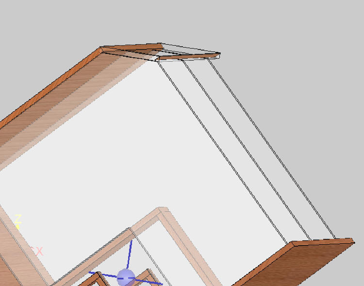

I'm trying to build a corner cabinet and remove one side of the back. But when I try to do this w/ a corner seed cabinet the entire back is removed. Can someone tell me if this is possible. I can do this w/ a regular base cabinet but it seem to involve.
Re: Corner cabinet
Hi Patrick
This is how I do it
Take one side of back OFF.jpg (74.12 KiB) Viewed 4894 times
Take one side of back OFF_1.jpg (44.74 KiB) Viewed 4894 times

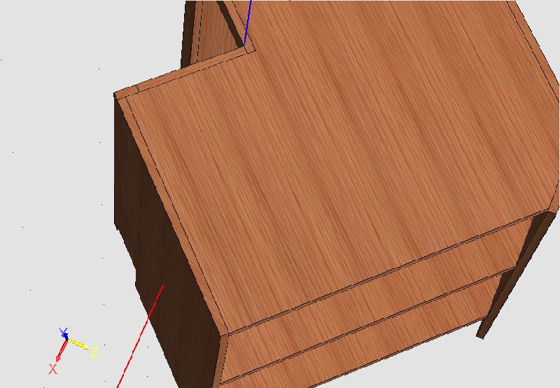

Hi George,
Thanks for the help. It works fine but how do you make the deck and shelves become flush with sides and other back?

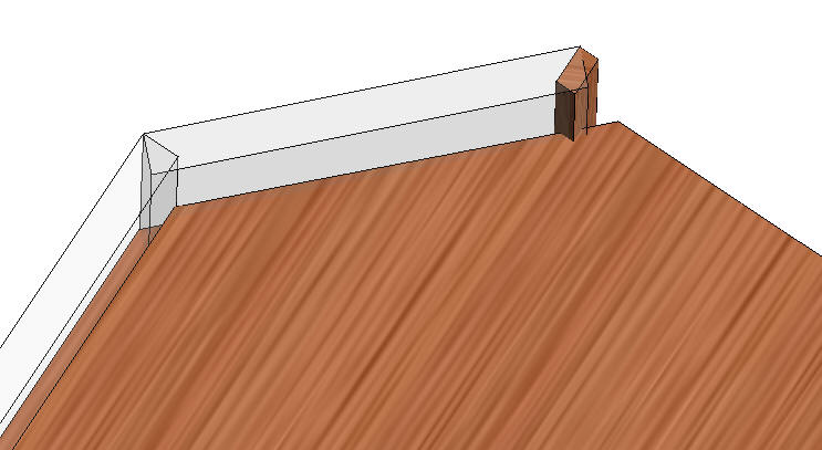

Re: Corner cabinet
Hi Patrick, add an inset to the back of the side panel equal to the thickness of the back material then increase the depth of the cab on that side. HTH
side flush.jpg (65.72 KiB) Viewed 4810 times
