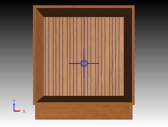

I just did this on the fly. Copied an existing material and opened in image editor. Added some black parallel lines (mspaint will do this or paint.net is really good, free). Saved the new image and added as new in ecabs material dialog. Made new sheet stock using the new image. Edited standard cab and replaced the back with the new sheet stock . Result is attached. Use different colors for the parallel lines to get a more realistic beadboard look
quick beadboard.jpg (28.68 KiB) Viewed 5687 times
