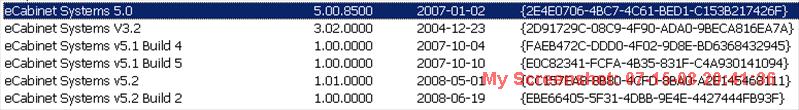

My system reports several different Versions of eCab in various places, depending on what utility I use to look with.
The WinXP Control Panel seems to show only Ver5, with an update, but another utility program, Syetem Information for Windows (SIW) shows much more, probably stuck in old Registry keys. (Don't you just LOVE the Windows Registry !)
The screenshot of the listing is attached (I hope)
I'm trying to clean up my system without wiping the HD and reinstalling EVERYTHING (kind of in-between a heart transplant and a full-on Resurrection) so can I wipe any references to the old versions? Would I be better off deleting all of them and re-installing VER5 Build 2 ? (Which reports as file/product version 5.2.18.0) ?

Hi Joe. The only installs that are safe to remove are the following in your list...
v5.1 Build 4
v5.1 Build 5
v5.2
They will merely remove the msi that is placed during the patch install. V3.2 & V5.0 will do a complete uninstall of eCabinets. I believe V3.2 will require the old disk to perform this uninstall.
