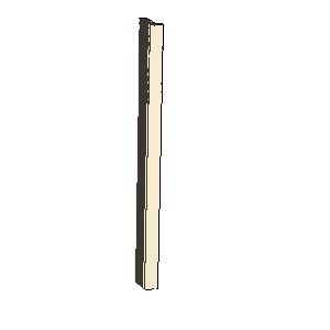

Does anybody have an easy and quick way to add fillers while in custom layout? Adding them in custom layout is real tricky. I normally add them as a diplay panel to the cabinet while in cabinet editor, but it's a little cumbersome, especially when you have to resize the cabinet. Any ideas or tricks?

Hey Ben, I use a cabinet with all the parts removed except one side and a MDF door.I place it using align to front, that way it's flush with the doors (frameless). I use a left and a right.
L filler RH.jpg (4.22 KiB) Viewed 4058 times

that's smart- thanks
