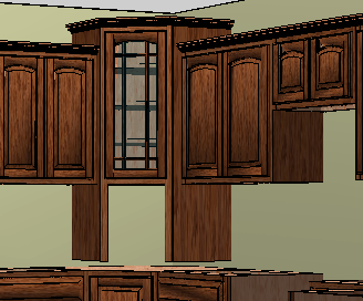

I am making an upper corner cab(54"h) that will extend down to the counter top, which will have a run of 30" upper cabinets mounted to both sides of corner, mounted at normal height above counter and have 2 questions.
1.the client would rather have a solid door rather than a tambour door,but they want the door to swing out of the way or up to gain the most counter space.By swing out of the way I me more than a 170 degrees,maybe so it could swing around the 1.625"w face frame to the side of cabinet.
2.when installing the cabinet I am sure their are some work around on how to place the counter under the corner cabinet being that I would like to have all cabinets installed beforehand.Client is having a tiled surface counter.My thoughts on installing are
-have a gap between the bottom corner cabinet and future counter and fill with trim after tile is installed.
-install cab. up 3" until tile is installed and come back and lower it,say only use a few screws into studs then drop down
-mount base cabinets only, wait on tile installation, then mount the upper cabinets,which not too excited about.
I have seen many of your web sites having corner cabinets built onto counters and I have never built corner cab this long or installed before.Any comments????
Scot

We have built quite a few of the corner uppers that set on the counter. We install them to the ceiling until the counter is in then go back and lower them and trim.
One thing we do different than your design is build them with a floor and bottom rail. If you did this, and had the substrate for the tile counter, you could set the cabinet on the substrate and tile to the cabinet. You wouldn't need tile under the cabinet.

That is a great idea.My base corner has .75" tops.I could just set it on top of it as long as I find the thickness of the counter.
What kind of hinge do you use for your door?
Other ideas from anyone else would be helpful.
Scot
