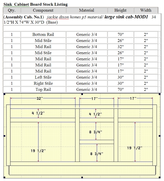

Is there a way to copy and paste the cut list into the LDE? It would be great if we could get something like this for the shop.
I have been coping every thing into another program to get this type of report, but it is a pain in the B*$$. But it does help out a lot when making frames. Nothing worse than getting ready to attach the frame only to find out something is wrong, especially after the frame has gone to the finish room. Not that anything like that has ever happened in my shop. :D
