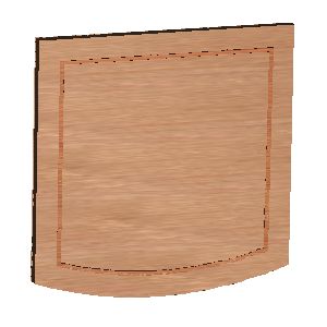

Something like this Philip?
Inlay.esa
(76.02 KiB) Downloaded 992 times
Philip Shantz
Posts: 414
Joined: Tue, May 10 2005, 9:58AM
Location: Bellingham, Washington
Re: Table top inlay banding
Post by Philip Shantz »
EXACTLY, Rick! How did you do that?
What I did was create the top, then in CE made a copy of it, took that to Contour, created edges, offset the lines in, then offset them again the width of the inlay, trimmed the lines, back out to PE, cut away the inside and outside, took that back to CE, aligned it to the corner of the top, set move increment, move it to position, brought in a cabinet of the texture I wanted, hilited the part, did the texture match. HTH Say that all in one breath. :joker:
