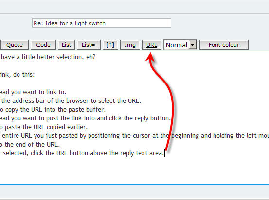

For posting the link, do this:
1. Open the thread you want to link to.
2. Click once in the address bar of the browser to select the URL.
3. Press ctrl-C to copy the URL into the paste buffer.
4. Open the thread you want to post the link into and click the reply button.
5. Press ctrl-V to paste the URL copied earlier.
6. Highlight the entire URL you just pasted by positioning the cursor at the beginning and holding the left mouse button while dragging to the end of the URL.
7. With the URL selected, click the URL button above the reply text area.
8. Edit the URL tags by replacing the first ] with =
9. Place a new ] just before the [ in the closing URL tag.
10. Place the text you want displayed in the link between the newly added ] and the [ in the closing URL tag.
11. Click the Submit button.
