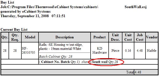

The buy list would be the only report that would give you a list of purchased goods. (Pulls, slides, hinges, ect) Under each line item on the
buy list you will see that it shows you what cabinet(s) it is associated with. I don't think this information can be exported to a different document or format. Let me know if this helps.

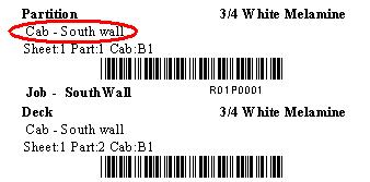

They are currently sorted by cabinet number/name on the label. Before writing the CNC at the control, you can print the nested sheets and the labels for each sheet. These labels have a cabinet number/name for the corresponding cabinet. See the attached image. Now you can use the buy list which has the hardware with the corresponding cabinet name. HTH

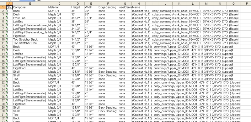

You can export your cut-list from eCabinets to excel, then go to the Sheet Component Listing tab and use the sort function to sort by Name for the primary sort and component for the secondary sort.
This will give you a list of all box components sorted by cabinet.

Thanks Todd and Kerry,
That the report I'm after which I can pass onto the staff.
If in Excel I can modify as well if required.
