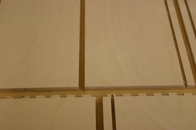

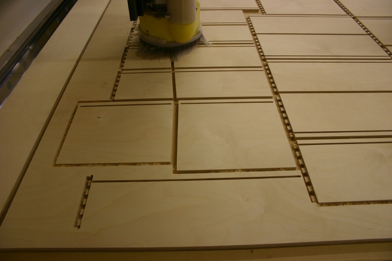

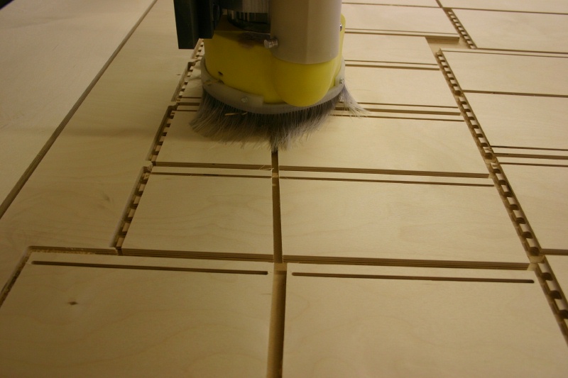

Somebody want to take a guess at what happened here. Cut everything as smooth as glass, but did not leave any skins although I set them at .020 skin thickness because I have a couple of narrow parts that are guaranteed to move. It cut all the parts, made a strange move over across the top of my drawer box parts, cut them in half and snapped the bit off when I estopped it to prevent any more parts from getting cut in half.
drawer box error 001 (2).jpg (112.04 KiB) Viewed 13154 times
drawer box error 003 (2).jpg (100.43 KiB) Viewed 13150 times

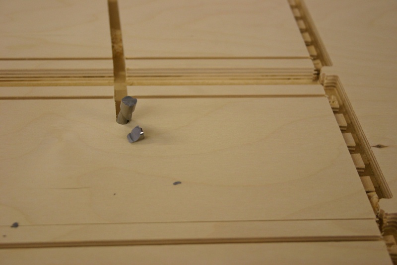

another
drawer box error 004 (2).jpg (91.43 KiB) Viewed 13153 times

I forgot to mention that the block stop did not stop it after it cut the first drawer in half. That is why I e-stopped the machine. It was on a path to ?????????

The drawer I used to create the batch of drawers is my standard drawer that I have saved. I just click and change the size in the Batch Area, write the twd and viola. Only this time it goofed up. ( I am trying to be polite :lol: )
We cut 4 sheets of drawers yesterday with no problems at all.
We did start the morning off with the gantry making a poping noise as is moved back and forth the x-axis, but we have had problems with this before. Blew all the dust off the machine and found some in one of the Belt covers and it seemed to stop after we cleaned it out but after that we cut some parts and everything was fine. We had just got through cutting a few cabinets prior to the drawers and they came out ok as well. I am sure there is a problem in the file, but my question is, how are we suppost to know when there is a problem until after we have made dumpster food out of the material?

When you select use tabs it will not leave a skin on the parts. We are looking at the use tabs function in Control Nesting and why your parts cut the way they did. I will let you know what we find out. Thank you

Damon, get the 4x8 baltic birch, my yield went up a ton, for me anyway I always had a 12" pc left on the end or something like that. I had to do some searching, but when I found it , I bought about 5 bunks. I am cutting into the last bunk soon and am getting ready to look for more.
As far as your boo-boo, I have had that happen twice in thousands of drawers, once right in front of someone I was showing off for, dovetail bit came right out and notched into the flip op bracket, never did figure that one out and just happy no onloookers got hurt! The other time it made a crazy cut like yours only a v-shape. ON that one you could actually zoom in on the nest and see the cut path.... I hope you didnt hex me making me talk about it because I cant remember the last time I had any problems cutting drawers and I cut a bunch for other shops around here, even if I dont cut there cab parts.
Also, I always skin my dovetails,.040 havent had to rcut on e in a long long time. Also I have a extra dust shroud without the brushes as I beleive the brushes being as stiff as they are were helping move small parts around.
