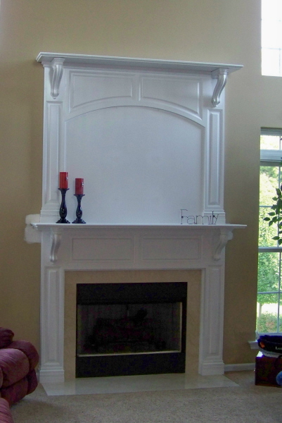

I am confused I had Damon make a arched vallance out of MDF with raised panels and beleave me it look great no rounded corners. It looked like it was assembled as a 5 piece door here is a picture
LaClair Mantel.jpg (178.55 KiB) Viewed 14869 times

I used a 1/16 ball nose to clean those corners up. That valance took a little over an hour to make modeling it out. That is the problem. These machines need to be making over a hundred dollars an hour to be profitable. If we could program the doors to be used with custom tooling and then be able to take that small ball nose and clean up the corners, that piece could have been made in maybe 10 minutes and YOUR price would have been much cheaper because it did not tie up the machine so long. The modeling feature is a WONDERFUL tool, it just take a long time to make anything. On one of a kind pieces that you might not use that profile again, the time is justified. On the other hand, if you are making MDF Doors on a large scale, The time it takes to model out a set of doors can kill you. It is just as cheap to outsource them and let the machine be cutting cabinet parts. That is what I do, and I have been asked before why I outsource the MDF Doors when I have such a GREAT Machine. It's all about the clock, and productivity. I am not complaining so don't misunderstand, the program is a good program. I am sure in time it will be a better program. I am just voicing some improvements that would help out tremendously.

I did have a little bit of cnc experience so my point being is you rough out the raise panel with a standard bit or one you had made, you do a tool change and run the 1/16 bit to clean up the corners along with a 1/32 deep dust cut to blend everything.
