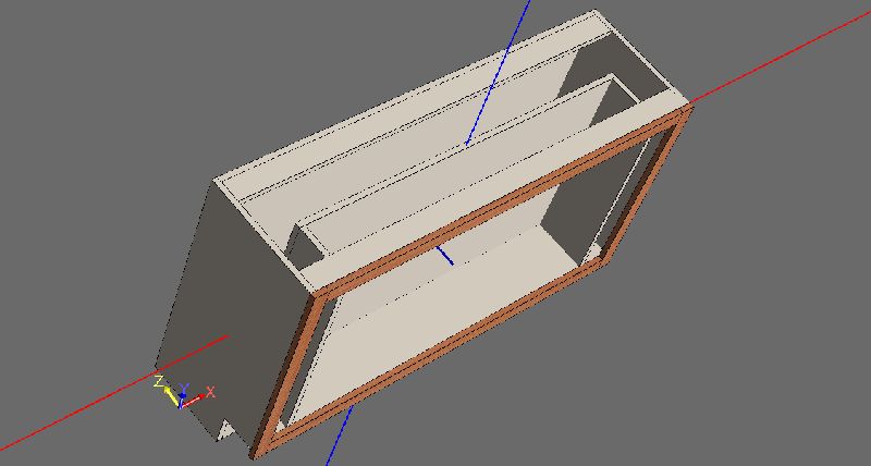

Thanks, Kerry. Using a stretcher worked to get the panel in place. I wanted to keep it inset from the left and right end panels, to allow for the pocket slides and doors to go past it - can I make cutouts in the sides of the "stretcher" with the part editor? If I slice a couple of inches off the left/right ends that way, will the "stretcher" stay centered?
I also need to place several 3/4"x2" filler strips against the sides for mounting the slides - use display panels? I tried using front-back stretchers for that, but eCab won't let me place them between the FF front and either the back stretcher or the narrow inset back. Partitions wont work here because they need to be in the middle (vertical) of the end panels to line up with the euro hinge borings on the doors (4" from top/bottom). I'll try to attach the cab file so far, for illustration.
Pop-Up TV Cab (Small).jpg (39.78 KiB) Viewed 5528 times
I can add the cab file if it'll help.........

You can do what you want using an up down stretcher with left right orientation. Make the stretcher width the width of your cabinet box inside less the gap you want to leave.
Use partitions with a back inset for the ends .
I would probably use display panels for your slide spacers. they won't re-size with the cabinet though.
