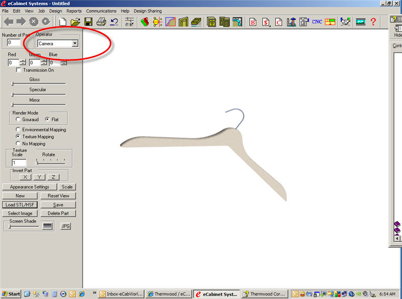

Re: Display parts editor
Set the "Operator" to Camera to move/rotate everything as a single entity.
