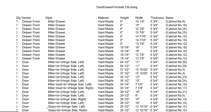

Use Alternate Source when you place your doors and then export your cut list to excel. There will be a tab in the cut list named Door, Drawer Fronts, ALT Listing and this will have all your info. You can then sort or edit at will.
door list.jpg (222.74 KiB) Viewed 6899 times

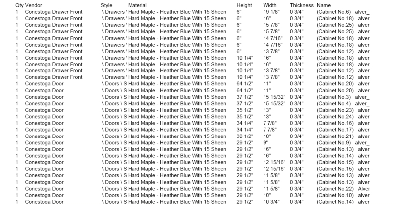

Gary,
Here is what I end up when I clean it up in excel.
door list_02.jpg (165.71 KiB) Viewed 6881 times
