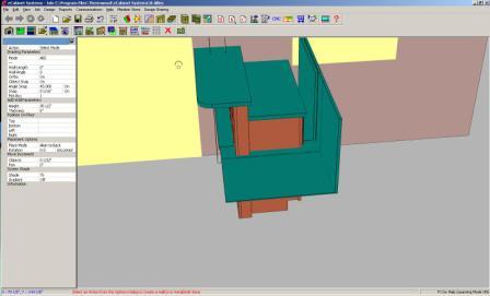

I have had the problem with the cabinet parts missing and being attatched to the counter top quite a bit. You can go to the counter top editor then return to custom layout and the extra parts attatched to the counter top should dissapppear. At this point, I usually save the job and close e-cabinets, then restart e-cabinets and continue on with the job. Here is a picture of the problem I have had. Also, if I remember correctly, if you take the cabinet with missing parts to the cabinet editor, mouse over the cabinet parts, they will have a large negative number for their sizes.
New Picture.JPG (13.63 KiB) Viewed 8048 times

Kerry Fullington wrote:Leo,
You need to find what is wrong with this job before you put any more time into it. A lot of times I save the cabinets from the room into a file then I re-draw the room and start placing the cabinets back in until I find the problem.
Post your job file.
I reverted back to just the walls and started over. I have to remember to put the countertops on as the last thing, and save it as a different file. Never did figure out what was up with the cabinet with missing parts. I did notice if you go to the countetop editor the counters revert back, but as soon as you start to add more cabinets the error occurs again. At that point the last thing I want to do is save a file with errors in it. I feel it is safer to start over than have a crash when you are nearly done.
