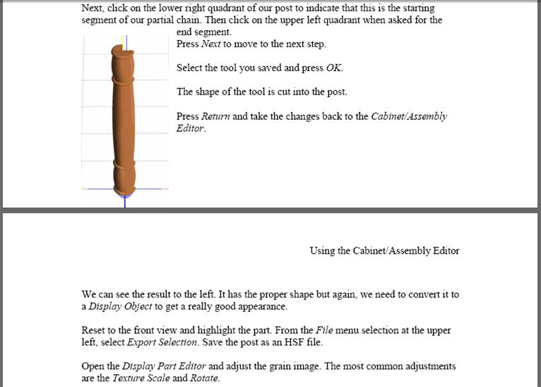

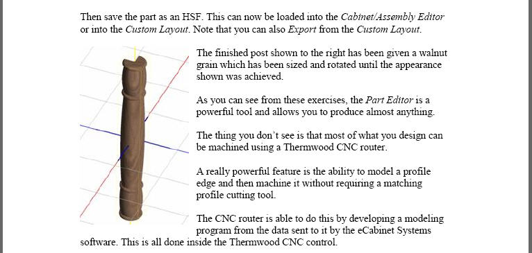

I feel that one should never try to learn something new while under the gun for a job.
Having said that, though, the procedure to create such a part only takes a couple of minutes at best and learning to create it doesn't take much longer.
The old "eCabinet Systems Made Easy" guide had a section on creating exactly such a corner post. Since it is not part of the software any more, you have to have it on your computer to use it.
Here is the section dealing with making a turned coner post (there are four images so it will take two posts):
Re: column
Final image...
